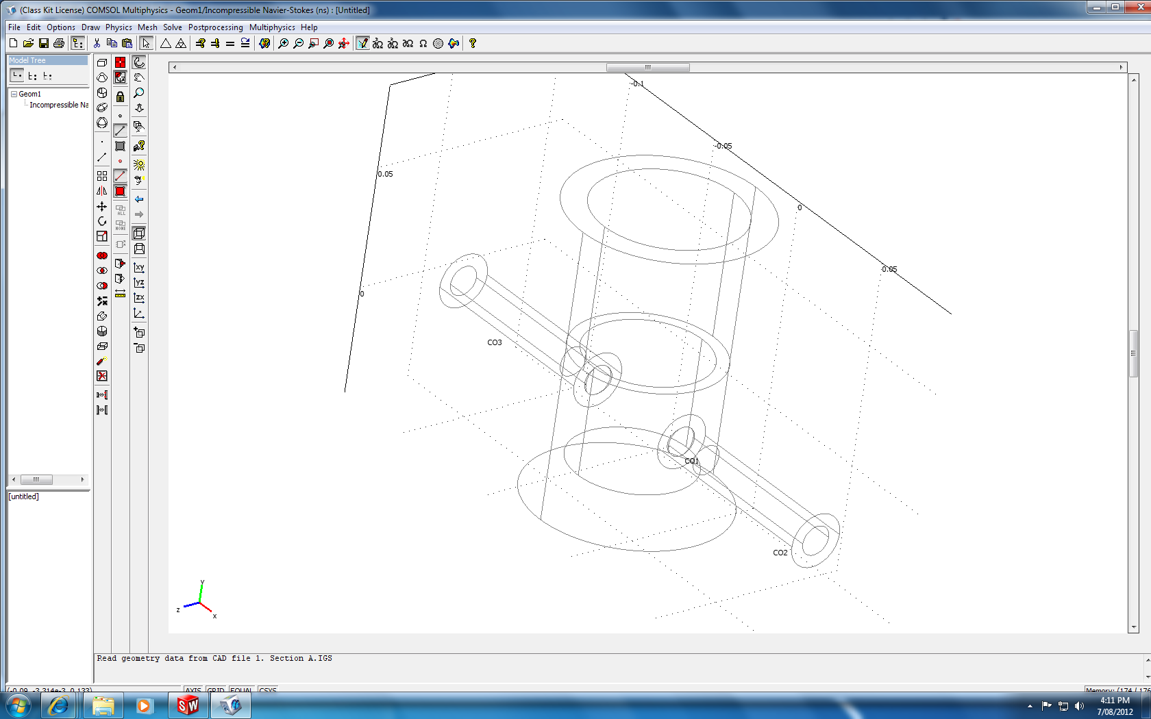

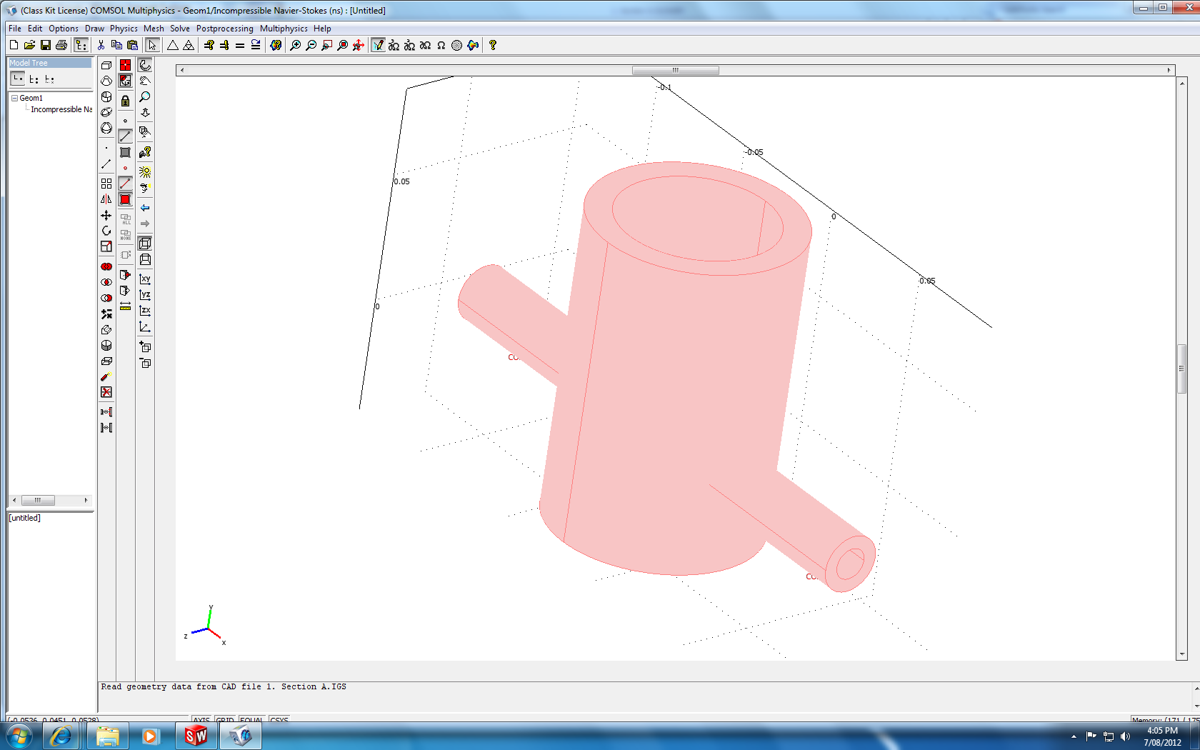

   <description>What he means is that you need to model in volume that the fluid occupies, not the volume of the container.&lt;br /&gt;&#13;
It looks like your fluid fills the volume that is equal to the union of two perpendicular cylinders. You can make a wide cylinder along the Y axis, and a seperate thinner cylinder along the X axis, and then use a union to join them. In my experience (albeit limited), I have had some trouble meshing models I created in solidwork (imported into COMSOL as STL files). If your geometry is simple, as yours appears to be. I would suggest modeling it directly in COMSOL. It's not as quick/convenient as SolidWorks, but it should work.</description>

   <description>Hi Brett&lt;br /&gt;&#13;
&lt;br /&gt;&#13;
Now you model of nozzle frame, not fluid inside. You have to make model of flowing fluid where you can select boundaries.&lt;br /&gt;&#13;
&lt;br /&gt;&#13;
Best regards&lt;br /&gt;&#13;
&lt;br /&gt;&#13;
Tero</description>

   <title>Help with fluid flow analysis on imported SolidWorks file.</title>
   <link>http://www.comsol.com/community/forums/fluid-flow/thread/30800/#p84318</link>
   <description>Hi all&lt;br /&gt;&#13;
&lt;br /&gt;&#13;
I have imported a SolidWorks assembly into COMSOL 3.5a using the IGS file format.&lt;br /&gt;&#13;
It is a smaller section of a larger nozzle that should produce swirling flows.&lt;br /&gt;&#13;
I have attached a screenshot of what it looks like, both solid and wire-frame.&lt;br /&gt;&#13;
What I am trying to do is a fluid flow analysis of a fluid flowing through it.&lt;br /&gt;&#13;
(In the model navigator I selected 3D, COMSOL Multiphysics, Fluid Flow, Incompressible...).&lt;br /&gt;&#13;
I am now trying to set boundary conditions so that the openings of the smaller ports are inlets&lt;br /&gt;&#13;
and the opening of the larger section at the top is an outlet, but the edge settings option in &lt;br /&gt;&#13;
the Physics drop down menu is grayed out and when in the boundary settings window, I can&lt;br /&gt;&#13;
only select the internal walls to set the boundary conditions.&lt;br /&gt;&#13;
&lt;br /&gt;&#13;
Am I going about this in the wrong way, or is there something that I don't know and am missing?&lt;br /&gt;&#13;
&lt;br /&gt;&#13;
Any help would be IMMENSELY appreciated.&lt;br /&gt;&#13;
&lt;br /&gt;&#13;
Thanks&lt;br /&gt;&#13;
&lt;br /&gt;&#13;
Brett</description>
