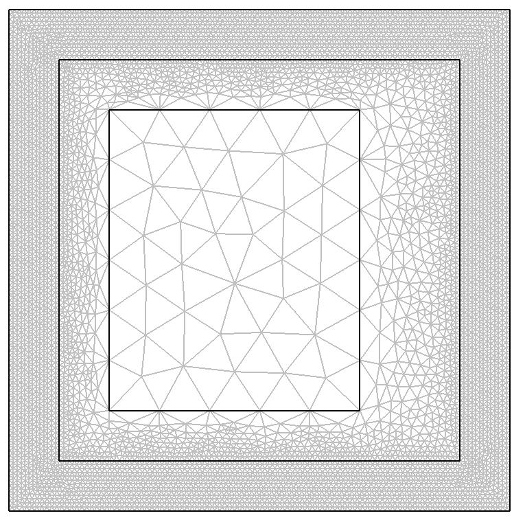

   <description>Hi, I solved my &amp;quot;funny indexing puzzle&amp;quot; :)&lt;br /&gt;&#13;
&lt;br /&gt;&#13;
The functions below might not work for all geometry and might be slow.&lt;br /&gt;&#13;
However, they do the job for me and you may modify the functions for your own needs.&lt;br /&gt;&#13;
&lt;br /&gt;&#13;
- Save the attached functions and add them to your matlab path (Matlab menu: File=&amp;gt;Set Path...)&lt;br /&gt;&#13;
- Export your fem structure to the Matlab workspace as &amp;quot;fem&amp;quot;.&lt;br /&gt;&#13;
- Run following command: &lt;br /&gt;&#13;
  fem=remove_internal_boundaries(fem)&lt;br /&gt;&#13;
- Import the new fem structure &amp;quot;fem&amp;quot; back to the Comsol interface.&lt;br /&gt;&#13;
&lt;br /&gt;&#13;
Good luck!&lt;br /&gt;&#13;

   <description>Not only the order of the boundary elements is different.&lt;br /&gt;&#13;
The param field of the mesh after meshenrich contains absolute values while&lt;br /&gt;&#13;
the param field of the original mesh contains relative values.&lt;br /&gt;&#13;

   <description>Thank you. Some empathy is also nice to get :)&lt;br /&gt;&#13;
&lt;br /&gt;&#13;
I digged a little bit in the mesh object. If I export a single subdomain,&lt;br /&gt;&#13;
extract triangle coordinates, build a new mesh... the import also doesn't work.&lt;br /&gt;&#13;
&lt;br /&gt;&#13;
The problem seems to be that meshenrich uses a differend indexing order&lt;br /&gt;&#13;
for the boundary edges. &lt;br /&gt;&#13;
&lt;br /&gt;&#13;
If i apply &lt;br /&gt;&#13;
&lt;br /&gt;&#13;
el=get(fem.mesh,'el'); &lt;br /&gt;&#13;
el{1}&lt;br /&gt;&#13;
el{2}&lt;br /&gt;&#13;
el{3}&lt;br /&gt;&#13;
&lt;br /&gt;&#13;
to the two meshes (first one after export, second one build from &lt;br /&gt;&#13;
extracted information) i get different results:&lt;br /&gt;&#13;
&lt;br /&gt;&#13;
Case 1:------------------------------------------------------------------&lt;br /&gt;&#13;
&lt;br /&gt;&#13;
type: 'vtx'&lt;br /&gt;&#13;
    elem: [1 8 12 20]&lt;br /&gt;&#13;
     dom: [1 3 2 4]&lt;br /&gt;&#13;
&lt;br /&gt;&#13;
type: 'edg'&lt;br /&gt;&#13;
     elem: [2x12 double]&lt;br /&gt;&#13;
      dom: [2 2 1 1 2 1 4 3 4 3 3 4]&lt;br /&gt;&#13;
       ud: [2x12 double]&lt;br /&gt;&#13;
    param: [2x12 double]&lt;br /&gt;&#13;
&lt;br /&gt;&#13;
 type: 'tri'&lt;br /&gt;&#13;
    elem: [3x26 double]&lt;br /&gt;&#13;
     dom: [1 1 1 1 1 1 1 1 1 1 1 1 1 1 1 1 1 1 1 1 1 1 1 1 1 1]&lt;br /&gt;&#13;
&lt;br /&gt;&#13;
Case 2:-----------------------------------------------------------------&lt;br /&gt;&#13;
&lt;br /&gt;&#13;
     dom: [1 2 3 4]&lt;br /&gt;&#13;
&lt;br /&gt;&#13;
      dom: [2 4 2 2 4 4 3 1 3 1 3 1]&lt;br /&gt;&#13;
&lt;br /&gt;&#13;
&lt;br /&gt;&#13;
--------------------------------------------------------------------------&lt;br /&gt;&#13;
&lt;br /&gt;&#13;
=&amp;gt; The &amp;quot;dom&amp;quot; numbers are mixed up.&lt;br /&gt;&#13;
(The order of the el-fields is also different, but this should not matter.&lt;br /&gt;&#13;
Above I wrote the el-fields in the same order for easy comparison.)&lt;br /&gt;&#13;
&lt;br /&gt;&#13;
&lt;br /&gt;&#13;
I do not like the Comsol-Indexing system!!! *grrrrr* &lt;br /&gt;&#13;
&lt;br /&gt;&#13;
It already took me a lot of time in the past.&lt;br /&gt;&#13;
I wrote something to find out the index of a point or boundary at&lt;br /&gt;&#13;
specified coordinates and now I can use my own indexing for &lt;br /&gt;&#13;
complex geometries. &lt;br /&gt;&#13;
&lt;br /&gt;&#13;
Maybe something similiar will work for this issue. &lt;br /&gt;&#13;
Or maybe I will not work with Comsol any more ;).&lt;br /&gt;&#13;

   <description>Hi,&lt;br /&gt;&#13;
I want to generate a mesh with variable mesh element size for semiconductor simulations. &lt;br /&gt;&#13;
My current approach is:&lt;br /&gt;&#13;
- Define a &amp;quot;mesh-size expression&amp;quot; mesh_size(x,y) in the scalar expressions.&lt;br /&gt;&#13;
- Copy the fem structure &amp;quot;fem&amp;quot; to a dummy fem structure &amp;quot;dummy_fem&amp;quot; &lt;br /&gt;&#13;
- Initialize the fem structure and calculate contour lines of the expression mesh_size(x,y).&lt;br /&gt;&#13;
- Take the contour lines as subdomain boundaries.&lt;br /&gt;&#13;
- Mesh the subdomains with different mesh sizes, according to the &amp;quot;countour-height&amp;quot;.&lt;br /&gt;&#13;
- Remove the internal boundaries.&lt;br /&gt;&#13;
- Transfer the new mesh of &amp;quot;dummy_fem&amp;quot; to &amp;quot;fem&amp;quot;, including all boundary conditions ect. &lt;br /&gt;&#13;
&lt;br /&gt;&#13;
If i do not remove the boundaries i would have to specify the physics for a lot of regions&lt;br /&gt;&#13;
where the physics is the same. &lt;br /&gt;&#13;
&lt;br /&gt;&#13;
Another approach was to start with a coarse triangle mesh and refine&lt;br /&gt;&#13;
the triangles if triangle-size is smaller than mesh_size(x,y). This&lt;br /&gt;&#13;
takes too much time and the mesh is too fine at some locations. &lt;br /&gt;&#13;
&lt;br /&gt;&#13;
Is there a way to import a mesh without meshenrich?&lt;br /&gt;&#13;
&lt;br /&gt;&#13;
If I find another way to get my wanted mesh point coordinates (and use the delaunay triangulation &lt;br /&gt;&#13;
function...) I would get the same problem with the mesh import. &lt;br /&gt;&#13;
&lt;br /&gt;&#13;
So the main question is: &amp;quot;How to import a mesh for a already existing geometry?&amp;quot; </description>

   <description>I have three subregions and mesh the subregions with different mesh size&lt;br /&gt;&#13;
(see attached figure).&lt;br /&gt;&#13;
After meshing i want to &amp;quot;remove&amp;quot; the internal boundaries&lt;br /&gt;&#13;
and keep the variable sized mesh.&lt;br /&gt;&#13;
&lt;br /&gt;&#13;
At the end there should be only one subregion but the mesh should &lt;br /&gt;&#13;
stay &amp;quot;the same&amp;quot; as before. &lt;br /&gt;&#13;
&lt;br /&gt;&#13;
How can I convert the internal boundaries to triangle edges&lt;br /&gt;&#13;
of a &amp;quot;combined mesh&amp;quot;?&lt;br /&gt;&#13;
&lt;br /&gt;&#13;
&lt;br /&gt;&#13;
&lt;br /&gt;&#13;
&lt;br /&gt;&#13;
&lt;br /&gt;&#13;
&lt;br /&gt;&#13;
</description>
