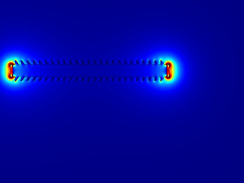

I am trying to follow this explanation and believe I have done all of the steps, but I don't think my answer makes sense. I want to model the electric field between two gold electrodes, each on one side of a pyramid filled with air. How can I get the electric field lines to show? Is this not possible with air in between? My aim is to try and model electrokinetic transport effects. The applied potential will cause a solution to be expelled from the pyramidal reservoir. I have attached my model.

I see a couple of problems with your model:
first of all, with a conductivity of 0 in electrostatics you cannot see electrokinetic transport effects. In reality, with a perfect insulator between two electrodes, there won't be any carrier movement because there are no charge carriers.
secondly, your mesh is very coarse with a minimum element quality of 0.02. This should be improved.
last remark is, I don't think electrostatics is the correct interface for modelling electrokinetic transport effects. It should include electrochemistry.
