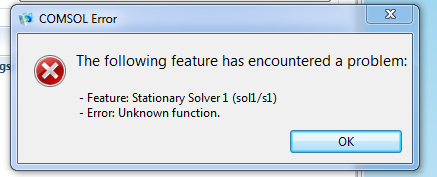

I am new to Comsol Multiphysics 4.2a. I built a model & try to run it but after clicking compute and it gave me an error
specifying
the following feature has encountered a problem:
-Feature: Stationary Solver 1 (sol1/s1)
-Error: Unknown Function.

Maybe you should check again your inputs (function expression, parameter, variables....),
And this link below hopes to help you: www.comsol.com/community/forums/general/thread/25832/

Hi , the Model I built is somehow running after checking the function and variable function. But my Variable expression has actually the rate expression where one of the concentration term (cD) is raised to 7.5(fraction) . How to write this term fraction in Comsol Multiphysics 4.2a. If I use the fraction term, the comsol is not able to evaluate the expression. if I am making it a whole number 8, then I am getting wrong result and concentration profile is not converging for any reactant & product.
