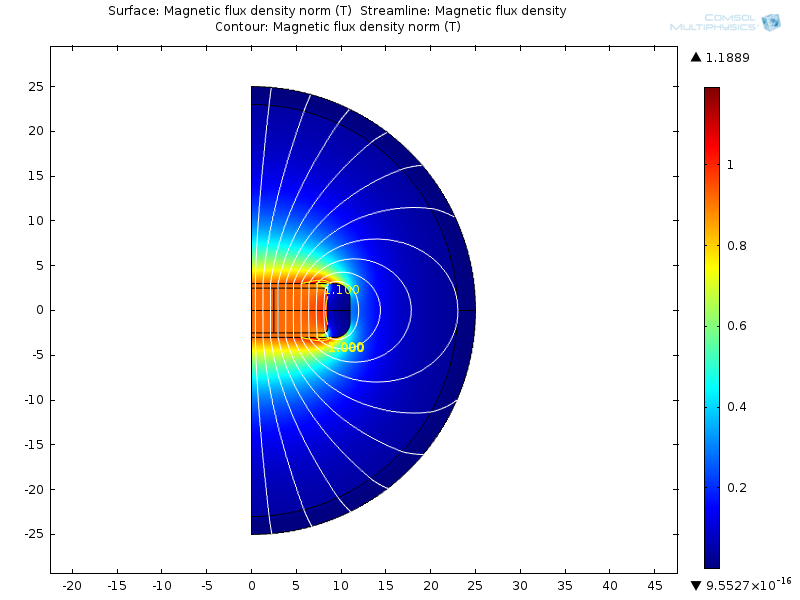

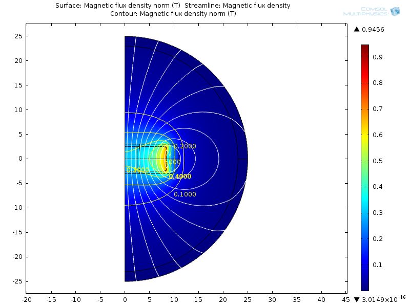

So my way is to define a specific "Magnetic Flux Conservation 2" for the magnet and set the magnetisation M to the Hc value of the magnet. Assuming that it is a hard magnet with a constant mu_r close to 1. This is not fully your case as Br/Hc = 1.25 quite high from my experience but OK.

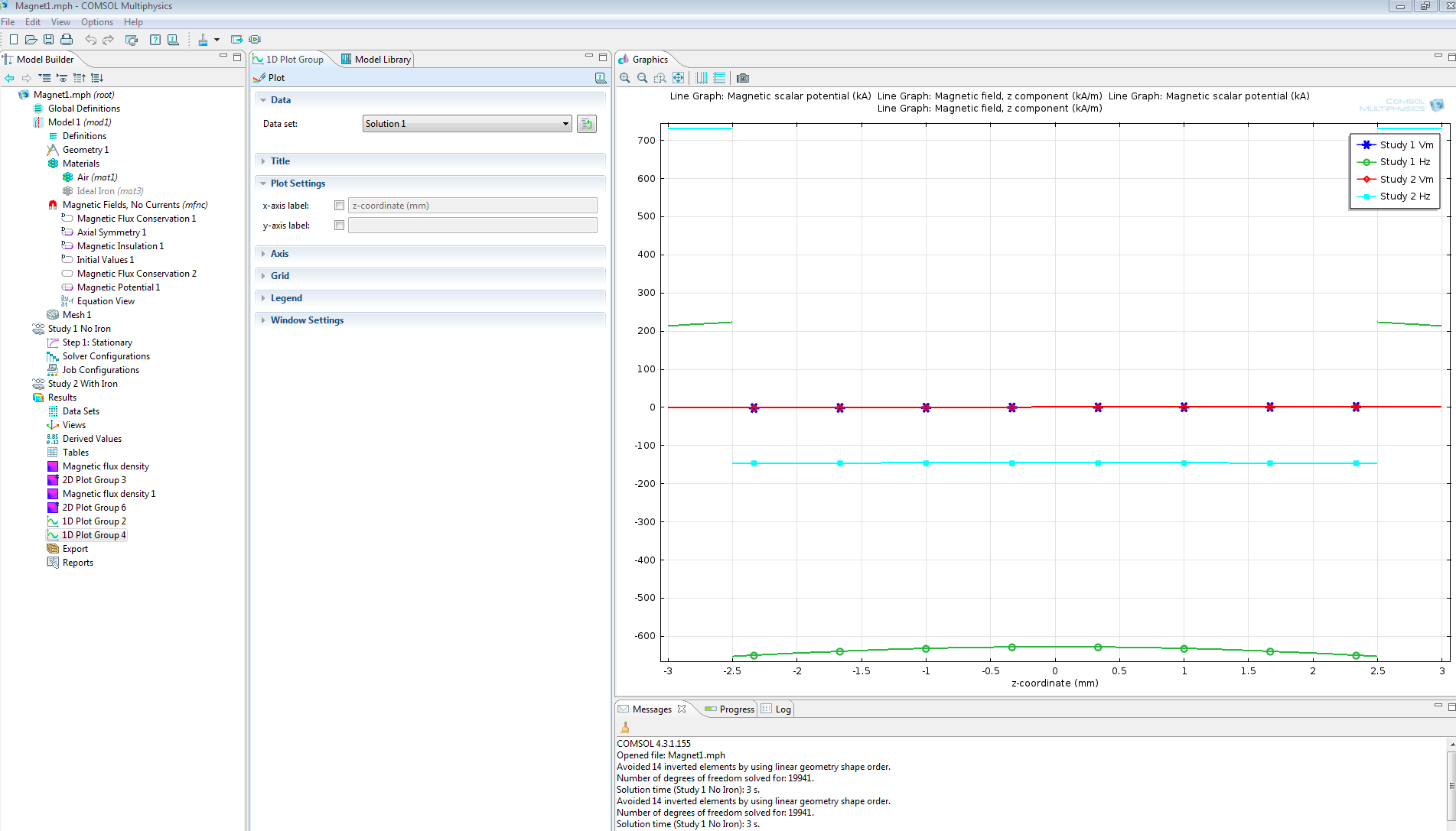

You have hereby a model, where the magnet is in free air, and is shortened with a perfect iron mu_r=4000 and an air gap you can adjust. If you set it to 0.5 or 0.1 mm you will see that the Hz value in the magnet and the airgao has a difference getting close to Hc, and the Bz is getting close to the Br, which for me is showing that the model is quite OK

The story of shortening with iron is just my way of validating the model, not any need for your final model. But when you define a magnet the Br corresponds to a magnet in free air/vacuum, the Hc to a magnet "short circuited" by a fictitious INF mu_r material. So one I have defined my magnet in 2D axi in my case I check that the filed just above the magnet reproduces the Br and Hc values.
the magnetisation is a material property, but the true field around a magnet depends also on the magnet shape, you see that in the field concentration on all corners in ACDC (and elsewhere) if the absolute values you calculate by FEM on sharp corners might be wrong, the field concentration effect is a true physical effects (lightening goes or arrives on sharp edges etc) therefore I always round off all my sharp edges (whenever possible in ACDC
