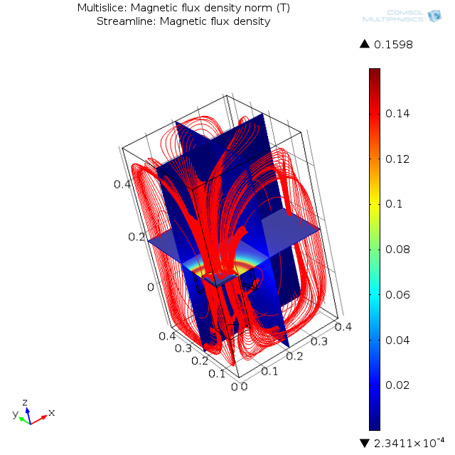

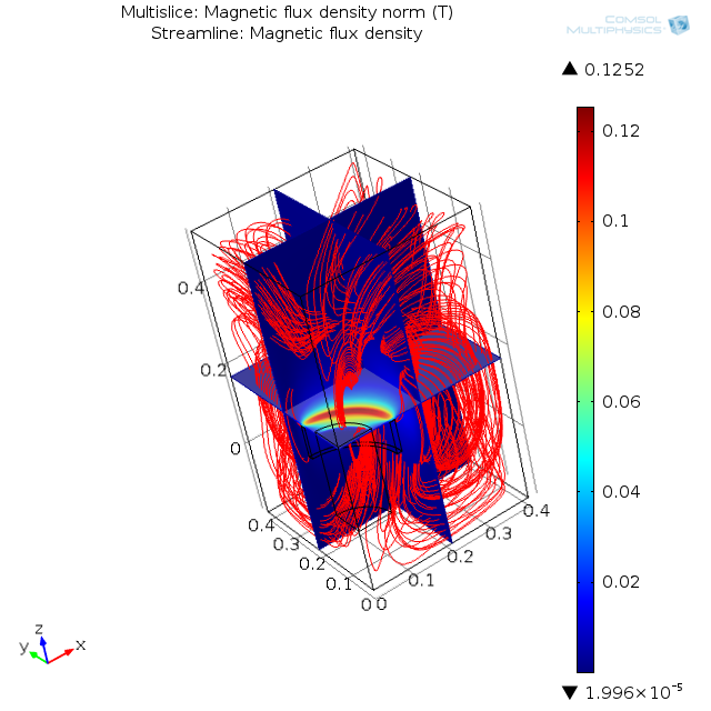

I want to compare mf and mef physics in order to know which one I have to use for my study.
I work with a coil and a conductive core. I'm interesting in the electromagnetic power dissipated in conductive elements mf.Qh and mef.Qh respectively.
Under same excitation set up (current surface like in cold crucible tutorial) I obtain a huge difference between values of dissipated power in the core: mf.Qh=12.14 kW and mef.Qh=3.7 kW
Mesh is the same for the 2 physics and increasing mesh density has no significant impact on results.
Magnetic fields seems to be very different in the 2 cases, i join a picture of streamlines
I attach as well my simple model.
Can someone can explain this huge difference?
Thank you

check the dependent variables: in MF it's the magnetic filed via the magnetic vector potential A, MEF adds in also the Electric Potential = Voltage (hence more degrees of freedom and heavier to solve)
If you study the induced currents, you would probably need the voltage for solving correctly, but in MEF you can add an "Amper law's" alone, skipping the current conservation or Electric potential part for some domains, check the equations

you do not need to, but if you have i.e. some air without any conductivity, you cannot get a "current conservation" variable running correctly with 0 conductivity.
Then its better to add a simple "Ampere law" node and select only the air domain (and leave the rest in Ampere law with current conservation), and solve in MEF with V there where the current can flow and as MF where there is no current flowing
Check carefully the equation tab (not COMSOL equation node) for ampere law and Ampere law with current conservation
