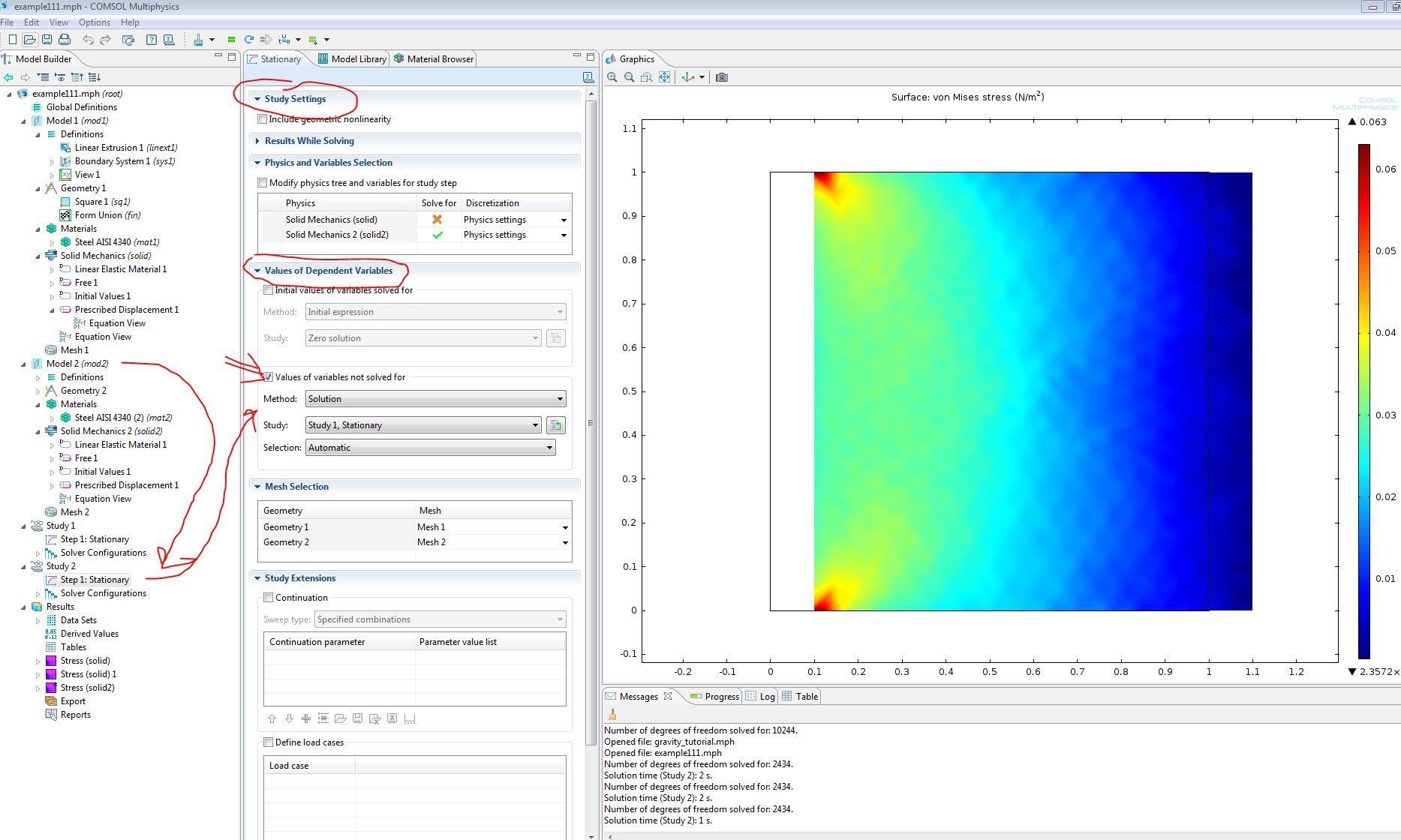

you need to tell study 2 where to read the data from, its done under the Study Settings _ Values of Dependent Variables check: Values of variables not solved for : Solution / Study 1 Stationary / Automatic
Attachments:   Example111cap.JPG
