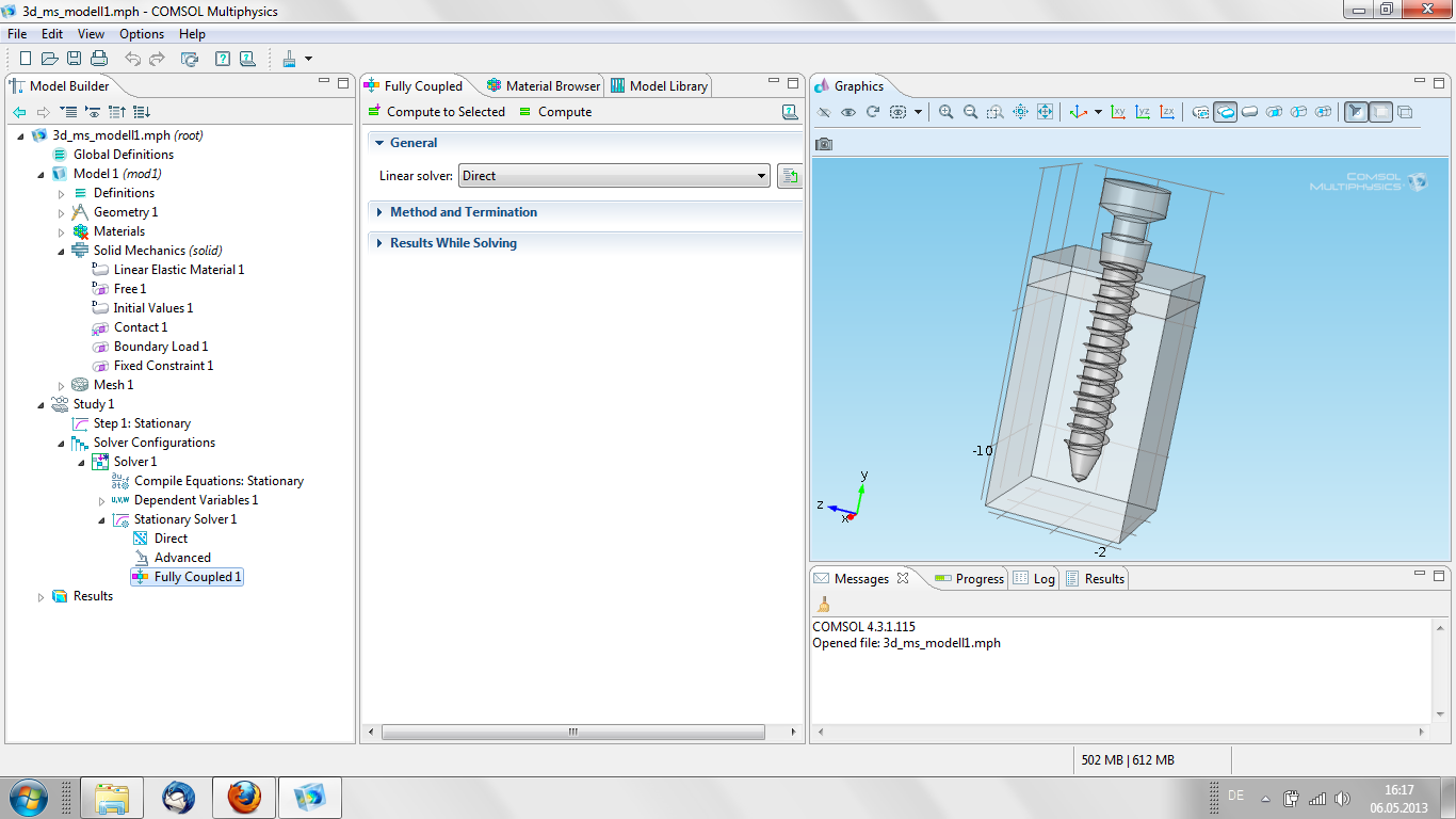

I want to simulate a screw in a boneblock which is bonded with a force vertical to the screw axis (see picture). The two blocks are a union with differend materials. There are used 3 different materials: the screw, the cortikalis (smaler block) and the cancellous bone (bigger block). In Finish I've form an assembly, activated Create pairs and the Pair type is Contact pair. I 've create a contact pair between the srew surface an the bone in Definitions. In boundary conditions I've assign the Contact Pair and the load in the screw head. The bone surfaces are fixed Constraints. A free tetrahedral mesh is used.
I used the stationary solver, solved in the direct way with MUMPS and fully Coupled. But the Solver don't convert.
Maybe the solver is wrong for this probem or I've forgot something. Can you please help me?
What is the best solver for my contact problem and what I did wrong?
Thank you for your help
Ariane

the red cross at the Materials node indicates that material assignments are missing. You have quite a delicate geometry there. I would recommend to test the boundary conditions in a simpler setup and in 2D axial and then get back to 3D.

1. Something is wrong with the solver sequence. A contact problem should have a segregated solver. Regenerate the solver sequence.
2. Check the scaling of the contact pressure under Dependent variables so that it is relevant for your physics.
3. Assembly problems like this are often singular in the initial state before contact is established. If this is the case, please refer to the documentation and Knowledgebase about how to avoid that.

MUMPS is just fine for this problem. You could also use PARDISO. More important is that you've selected the Segregated Solver rather than the Fully Coupled as suggested by Henrik. The default solver sequence should generate with the Segregated Solver if you are not sure how to set this up yourself.

Thank you for the help. I tried all you said (changed the scaling factor, used the segregated solver, set a small initial contact pressure). But when I use the default settings with the segregated solver, there are two steps a segregated (for the displacement) and a lumped (for the contact). With this default settings the cylinder don't flexure but becoming thicker. If I use only the segregated step for the displacement and the contact, the cylinder flexure. In both settings the convergence plot is not so good.
What should I do?

Based on the figure you posted that is a tough contact problem to solve! In addition to the suggestions mentioned above I would look at the convergence log closely and also monitor the non-converged solution during analysis (via the “Results While Solving” section in the Solver window). That may provide clues on what is causing the convergence problems.
