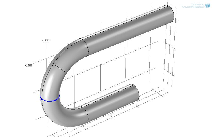

Hello, I have a problem when doing a simulation with a bend pipe meshed by shell element. The results of principal strains are one time larger than meshed by solid mechanics. But the results of principal stresses from both shell and solid models are the same.

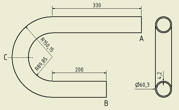

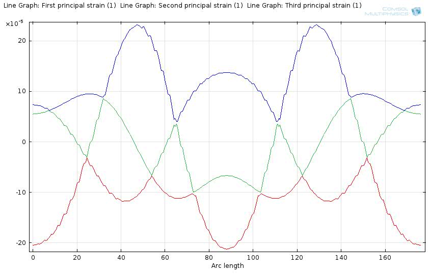

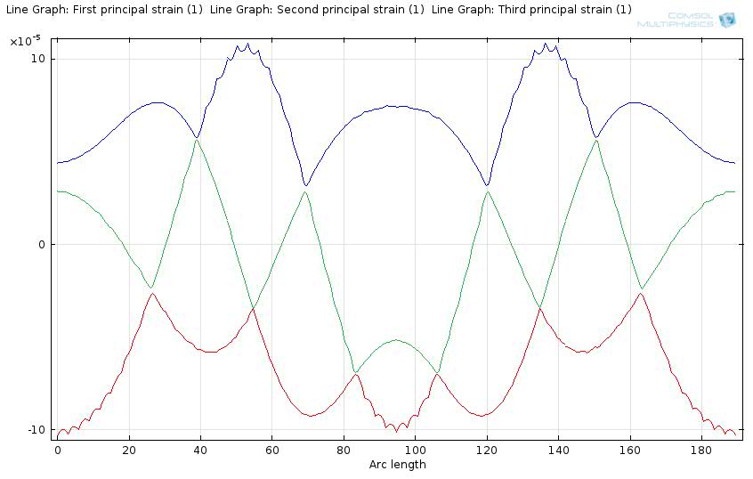

The parameter of the bend pipe, Position for analysis and line graphs for principal strains are uploaded as Attachment. In my Simulation, the pipe is loaded by 300N downwards on cross section A (see photos), cross section B is fixed. The material is structural steel. The position for plotting graph is an outside circle on bend pipe (position C in photo). There are two photos show the principal strains from shell element and solid mechanics. That's obvious to observe the big difference between two graphs.The results of principal strains by shell element are one time larger than meshed by solid mechanics.
And I have also simulated with the shell and solid models in software Autodesk Simulation, the results of stains and stresses are the same as the one from solid model in Comsol . So it means the result of solid model in Comsol is correct,the problem now is just the inaccuracy of principal strain by shell model in Comsol. Is it a mistake from setting and operation by shell element, or maybe a bug in Comsol?

I simulated your problem with shell interface, and got same results as yours. I modeled a thin-walled tube before with wall thickness 1/20 of the tube radius, and my results are identical to some published data. Your tube is relatively thick, therefore thin shell theory may not be very accurate. It is interesting that autodesk simulation gives more accurate results. I am guessing they are using a different formulation for the thin shell theory equations that also support thick wall structure.
You can try reduce the wall thickness see if COMSOL can give you good results and find out the critical ratio between wall thickness and local curvature (for tubes, it is the radius), and avoid using the shell interface when the thickness to local curvature ratio is larger than the critical value.

Regarding this problem, my understanding is that the thin-shell theory essentially assumes that the strain in the transverse direction is zero. You can check the magnitude of the transverse strain from the results of 3D solid element relative to the in-plane strain, and see if neglecting it is a reasonable assumption. If the transverse strain is large, then the discrepancy of the results from two approaches are due to the limitation of thin shell theory itself. Let me know what you find.

Thanks for reporting this bug. This will be fixed for the next version scheduled to be released in October 2013.
It is a problem in a postprocessing variable, and does not affect any other aspects of the shell results than the bending contribution to the total strain. The underlying results (the membrane, bending and shear strains) are not affected.
