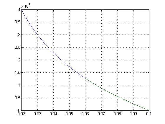

Analitically, I should have the potential as:
For the innermost part of the ring, the one that has a boundary with electric potential, the potential inside this domain is defined as:
V1(r) = V_boundary + (V_boundary - V_ground) * log(r / r_min) / log (r_min/ r_max )
For the outermost part of the ring, the one that has a boundary with ground set, the potential inside this domain is defined as:
V2(r) = V_ground + (V_boundary - V_ground) * log( r / r_max ) / log ( r_min / r_max )
Where V_boundary is the potential, V_ground is the ground, r is the radius of the point where I want to calculate the potential, r_min is the innermost part of the ring and r_max is the outermost part of the ring.
Plotting this for
1) V_boundary of 40.000 V,
2) r_min = 0.02 m,
3) r_max = 0.10 m
4) each domain having 0.04 m
(so 0.02 -> 0.06 m is domain 1, and 0.06 -> 0.10 m is domain 2)
5) sigma_domain1 = 1e-15 S/m
6) sigma_domain2 = 1e-16 S/m
7) epsilon_r_domain1 = 2.2 -
8) epsilon_r_domain2 = 3.5 -
I **should** have something like this:
-- Attached file : Image_analytical

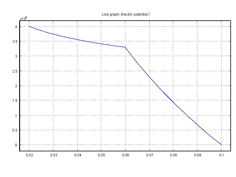

Using this model, or using its counterpoint axi-symmetric 2D model, I keep getting this result:
-- Attached file : Image_comsol
I've tried using Union mode and Assembly mode for creating the geometry, but alas, it's still the same. I've attached all 3 models which basically all give the same result, different than the one I should be getting analytically.

Edgar J. Kaiser
Edgar J. Kaiser
Certified Consultant
emPhys Physical Technology
June 12, 2014 4:27pm UTC in response to Lucian Viorel
Re: Comsol 4.0 : electric currents - el. potential V continuity between two adjacent domains?
actually I would expect the COMSOL result and not your analytical calculation. The potential is obviously continuous at the internal boundary, but with a kink,which is to be expected, because the conductivity changes. And thus the field is discontinuous.

Lucian Taranu
Lucian Taranu
June 13, 2014 9:20am UTC in response to Edgar J. Kaiser
Dear Edgar,
Thank you for your reply.
However, I can not agree with you on this matter, considering the following:
- the conductivity, as its constant in regards to space and time (does not depend on "r" or on "t"), does not interfere in the expression of potential V, nor in the expression of field intensity E.
I may be wrong, but can you please correct me?
The regime I am using (electric currents, stationary) isn't governed by these expressions? :
1. E = - grad V
2. div J = 0
3. J = sigma * E
And that my 2D geometry has symmetry and can be considered as a 1D geometry with variations of just "r", my expression: [ div ( sigma * ( - grad V ) ) = 0 ] turns into ( in cylindrical coordinates, with variations just on the "r" axis ):
( 1 / r ) * [ (d / dr) * r * sigma * [ ( d/dr) * - V ] ] = 0.
if I am considering that expression and the expressions I've mentioned above in the post regarding properties of material and values of expressions at geometric borders, more specifically:
i) V_domain1 ( r = r_min ) = V_potential
ii) V_domain2 ( r = r_max ) = V_ground
iii) V_domain1 (r = r_med ) = V_domain2 ( r = r_med)
iv) E_domain1 (r = r_med ) = E_domain2 ( r = r_med)
with r_med being the radii of the border separating the two domains within the ring
( from 0.02 m to 0.06m the first domain, and from 0.06 to 0.10 m the 2nd domain )
if I integrate considering all of the above I will have:
=> [ d/dr * r * sigma * [ (d/dr) - V(r) ] ] = 0 ( simplifications by 1/r as the expression in the right equals to 0 )
=> [ d/dr * r * sigma * [ (d/dr) V(r) ] ] = 0 ( simplifications by a minus sign)
=> r * sigma * [ d/dr V(r) ] = - ConstantA ( integrating the previous expression, on the left removing the d/dr and on the right integrating leaves a constant )
=> [ d/dr V(r) ] = ConstantA / ( r*sigma ) ( defining d/dr V(r) as whatever else remains)
And considering that E(r) equals to minus d/dr V(r) then we'll have E(r) equals to minus the expression on the right.
Then, if we integrate another time, we'll have V(r) as
=> V(r) = ConstantA * log(r) /sigma + ConstantB
Thus, I'll be left with:
E_domain1(r) = - Constant1 / (sigma_domain1 * r)
V_domain1(r) = Constant1 * log(r) / sigma_domain1 + Constant2
E_domain2(r) = - Constant3 / (sigma_domain2 * r)
V_domain2(r) = Constant3 * log(r) / sigma_domain2 + Constant4
With the expressions of the constants as following: (deduced from the system of equations i)- iv) )
Constant1 = (V_potential - V_ground) * sigma_domain1 / log(r_min / r_max)
Constant2 = V_potential - (V_potential - V_ground) * log(r_min) / log (r_min / r_max)
Constant3 = (V_potential - V_ground) * sigma_domain2 / log (r_min / r_max )
Constant4 = V_ground - (V_potential - V_ground) * log(r_max) / log(r_min / r_max)
And introducing the constants in the expressions of E and V I will be left with:
V_domain1(r) = V_potential + (V_potential - V_ground) * log(r / r_min) / log(r_min / r_max)
V_domain2(r) = V_ground + (V_potential - V_ground) * log(r / r_max) / log(r_min / r_max)
E_domain1(r) = E_domain2(r) = - (V_potential - V_ground) / ( r * log (r_min / r_max) )
Thus, as the material properties aren't varying with coordinates they will not interfere in this regime and I should have a smooth potential curve from one side to the other of the ring, governed only by the potentials of the two extremities, the fraction between the r_min and r_max and by the "r" of the point where the potential is to be found.
Are you saying that Comsol is using other expressions, and not these that I have mentioned above?
Or are you saying that I may be mistaking the regime that I am using for another one, and that my analytically expressions above aren't the correct expressions for this regime?
Thank you for your answer again, and hopefully you (or someone else) can provide an additional answer for what I wrote in this message.
Edgar J. Kaiser
Edgar J. Kaiser
June 13, 2014 9:31am UTC in response to Lucian Taranu
But the conductivity is different in the two domains, so it is dependent on a spatial coordinate. A simple analogy would be a serial circuit of 2 resistors. Say you have 1 Ohm and 9 Ohm in series and 1V attached to the terminals. This will result in 0.1 V and 0.9 V voltage drop.
Or maybe I misunderstand you setup completely,
Cheers
Edgar
Edgar J. Kaiser
www.emphys.com
Jeff Hiller
Jeff Hiller
COMSOL Employee
USA
Moderator
June 13, 2014 12:31pm UTC in response to Lucian Taranu
Your equation iv should read
iv) J_domain1 (r = r_med ) = J_domain2 ( r = r_med)
not
Jeff
Lucian Taranu
Lucian Taranu
June 13, 2014 2:36pm UTC in response to Jeff Hiller
Ahh, that explains some things.
Thank you very much for the answers!
