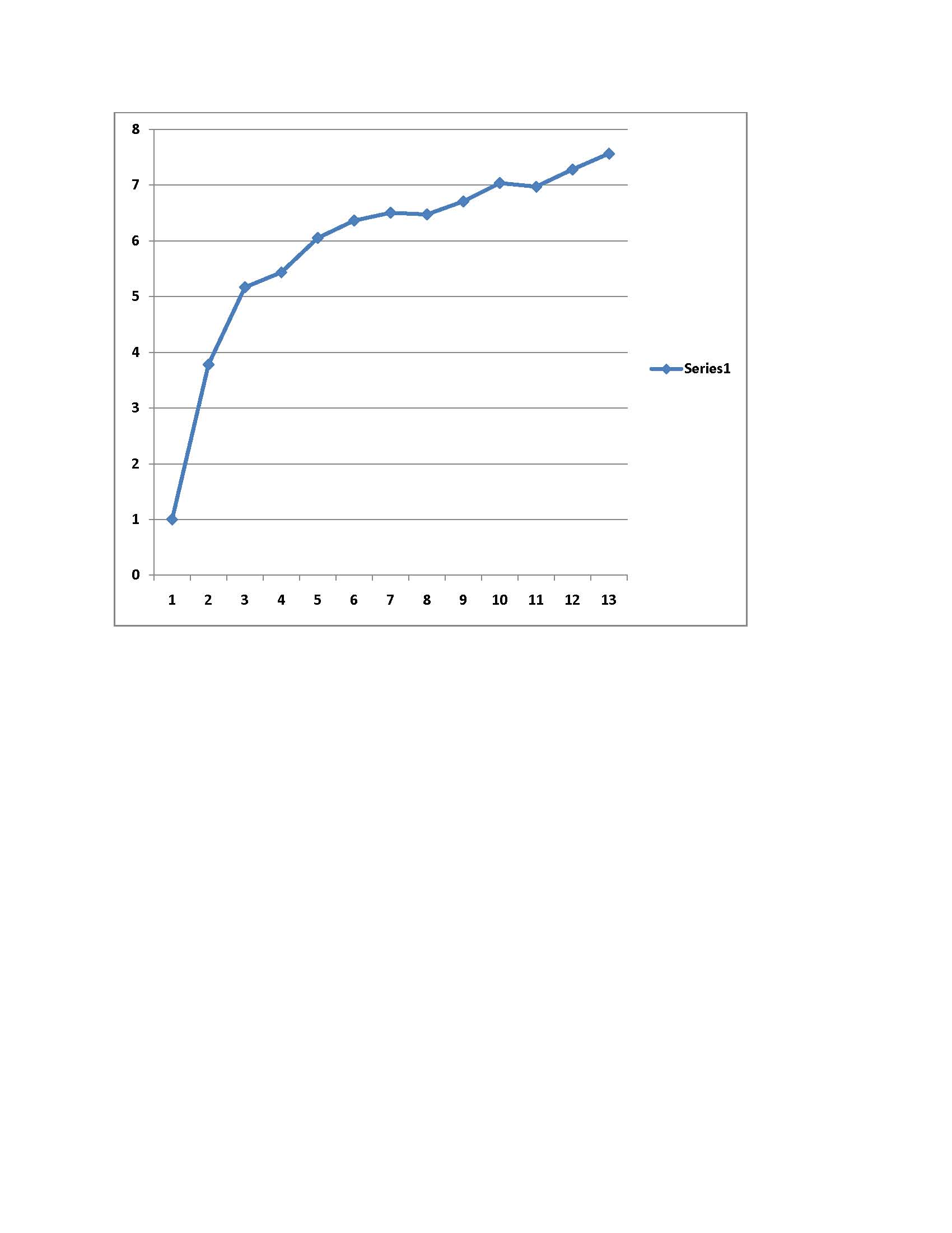

As you can see from the plot I attached, I get nearly 400% speedup (compared to your 20-30% speedup) on only 8 cores and single node with np=8.
You must be doing something different.

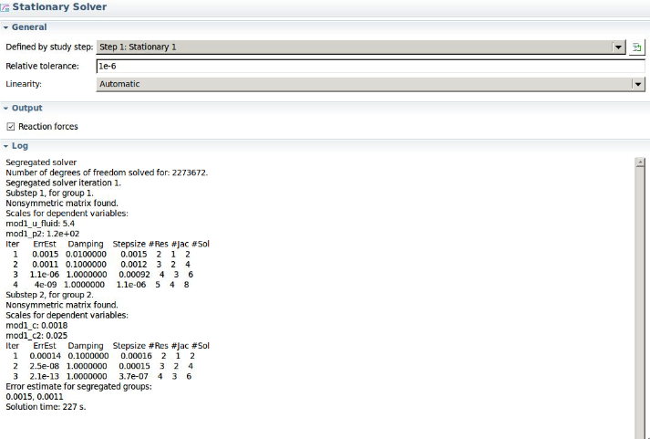

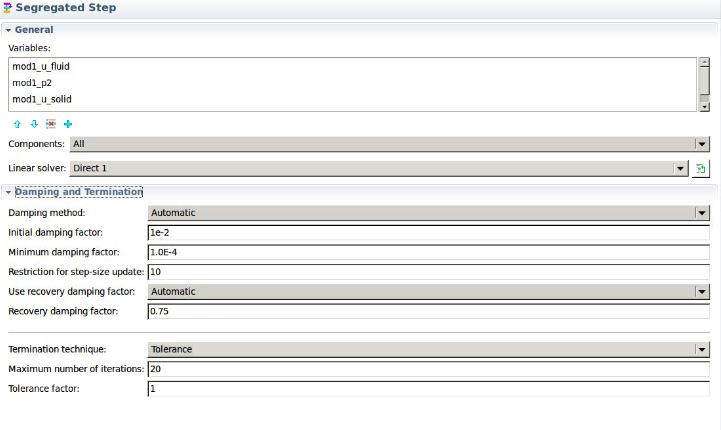

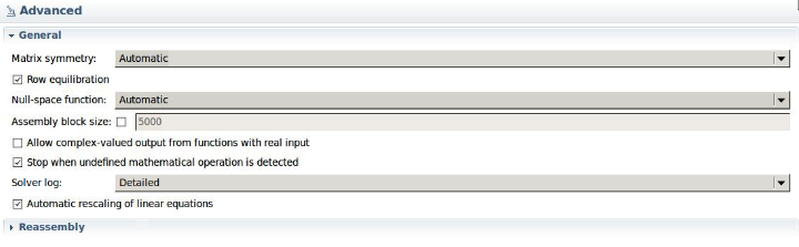

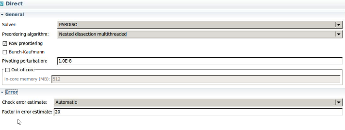

Here is the solver configuration (steady-state) with a sample log file.
Here I am using a segregated solver to add another PDE to solve (variable c), but in my tests above I have a fully coupled solver (without the second PDE) with single F.S.I physics.

Hi James and Danial,
I am also working on the same 48-cores Linux server where Danial did some of the scaling experiments, so I can confirm what he mentioned and also reinforce this with other observations.
I have a rather large 3-D problem (coupled flow with mass transport) that can fill all the memory (~256 Gb), and still the parallel performance is bad.
Just to illustrate what I want to say, I ran a quick (smaller) test a few minutes ago (~8 Gb and -np 8).
The problem is that Pardiso works only part of the time in parallel:
-> Solving the linear system starts with the assembly (~1 min), done fast enough,
-> Then in the matrix factorization step the solver spends ~10 min doing something on 1 core. This was checked with 'htop'. Pardiso evolution counter stays all the time at 0 % in this first phase.
-> Finally, you have the parallelized part working on 8 cores, done in ~3 min. In this stage only, the counter advances from 0% to 100%. Indeed, this second phase of the solution process is gaining speed with more cores, but the first phase is limiting. You can imagine that for the "real" problem this is even more bothering.
Comsol recommends iterative solvers for large 3-D problems.
However, no iterative solver could work on my problem - at all. Neither the Comsol support could give me an answer why is that.
So, if we want to speed-up the parallel solution with direct solvers, we should "get rid" of the first phase of Pardiso. MUMPS does exactly the same. Could it be the preordering?

Cristian Picioreanu
February 9, 2011 3:09pm UTC in response to Danial Tz
Re: COMSOL in parallel mode: a speedup of 20% using 4 cores?
Yes, I can confirm that the row preordering was the limiting step (because not done in parallel) !
Switching it off improved dramatically the solution time, without compromizing the quality of solution (for my problem, at least).
I will try to show you later also the scaling tests.
Cristian

No James, somehow you misunderstood my previous message.
1. The simulations for the smaller test case were run in parallel with Comsol started with -np 8 (see previous post).
2. In htop I saw CPU ~100% for longer periods in the preordering phase of the Jacobian matrix, then CPU ~800% in the second phase. So, one phase is not parallelized, the other one is. The 0-100% refers to the PARDISO counter in Comsol, not to the htop CPU counter (please read previous post).
I am already running now a larger problem (3 million DOFs, with 80 Gb needed by PARDISO), and the speed-up by running on multiple cores is indeed very significant when you uncheck the row preordering box. The was the time-limiting calculation.

So if I may ask it in yes or no terms, can or should we disable row preordering to utilize comsol's parallelism to the maximum limit? If yes, should it not be for MUMPs solver as well?
James Freels
James Freels
February 11, 2011 5:03pm UTC in response to Shakeeb Bin Hasan
I have not tested with/without row preordering. My recommendation would be to try it and see. It may be problem dependent.

The speed up is problem-dependent indeed, but in my case there was much gain with PARDISO when the preordering was disabled. I attach here my results for scale up experiments done on a 48-core server (2.2 GHz each CPU).
>>> Problem:
- Strongly coupled stationary laminar flow with solute mass transport. That is, the flow and mass transport equations must be solved simultaneously because the concentration affects liquid density, viscosity and (more importantly) the boundary conditions for flow (through osmotic pressure).
- Complex 3-d geometry with inlet, outlet, walls and periodic boundaries.
>>> Solution method:
- The system of equations is non-linear and with the given intial values 4 Newton iterations are needed for each solution.
The total solution time is reported in the attached file (roughly, you have to divide by 4 the time to see how much time one linear solution took)
- I tested on a mesh that leads to 3,057,962 DOFs. In these conditions PARDISO used maximum 80 to 90 Gb RAM.
- The tests are with nested dissection multithreaded preordering and without any preordering. However, I did not notice any improvement by the "multithreded" version. I use Comsol 4.1 update 2.
>>> Results:
- There is a clear improvement in speed when not using the preordering.
- All solutions returned are correct when 1, 4, 8, 16 and 32 cores are used.
However, interestingly, on 48 cores PARDISO did not correctly solve the system (neither with nor without preordering)!
- I attach results (scaling.pdf) for the total time (seconds), speed-up (time np/time 1) and parallel efficiency.
- For many cores, the preordering clearly becomes speed limiting and slows down the calculations 3-4 times!
Cristian
