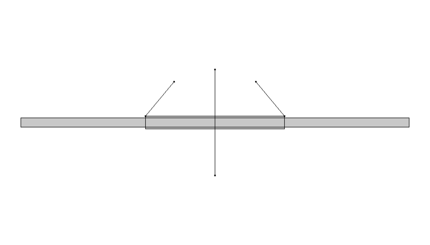

I try to make a diamond shape with curved corners.
1-How can I make a curve that goes through the three points? In addition, I would like that when the three lines are combined, it will form a continuous line.
2- I don't know if I complicate my life by doing this, if it does, your suggestions will be appreciated.
Thank you

Hello Vincent,
You can use an Interpolation Curve.
Best regards,
Jeff
