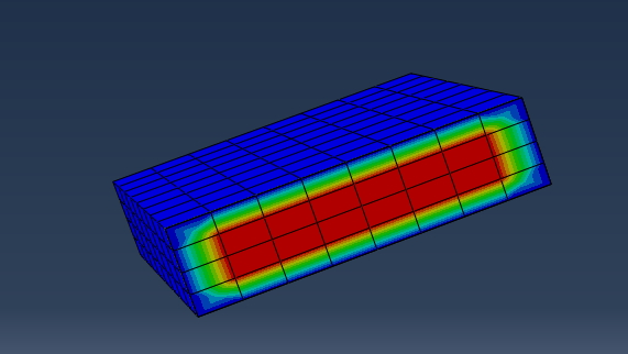

                                                    Thanks for your discussion.
I try this test in Abaqus. The temperature field does not depend on the mesh. I'll give you this result.
Regards
Regards

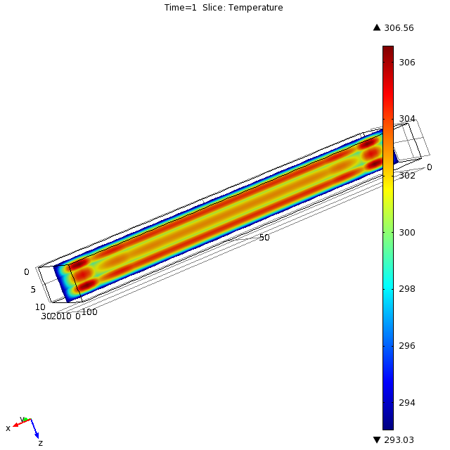

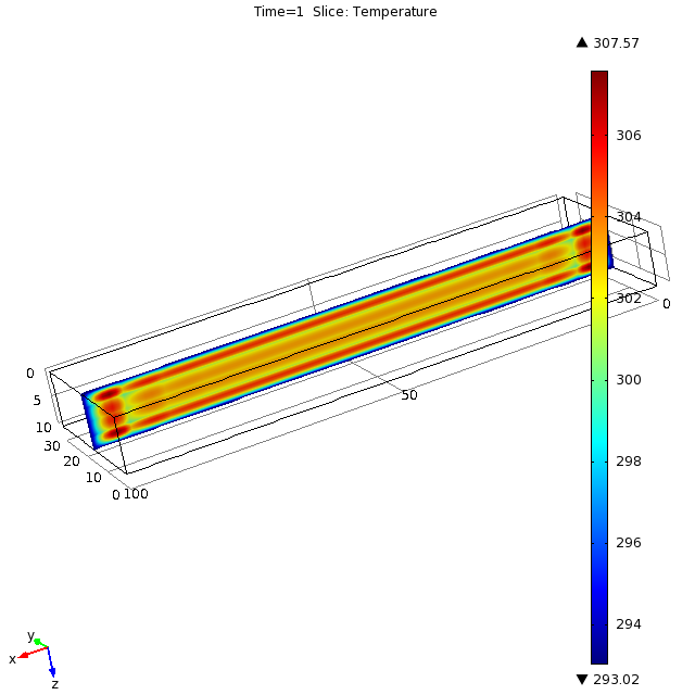

                                                    None of my examples is adiabatic condition. These examples take account  a convective flux with the environement :  q=h. (Text-T).
The result of temperature  in abaqus is continuous. But in the Comsol, the distribution of temperature is depend on layers of mesh as in the picture.
Do you have any opinion to improve this result?
Regards
Regards

                                                    Well, your original posting said you were trying to model an adiabatic condition...
Anyways, if you want help figuring out what's wrong with your model set-up, please post the COMSOL mph file.

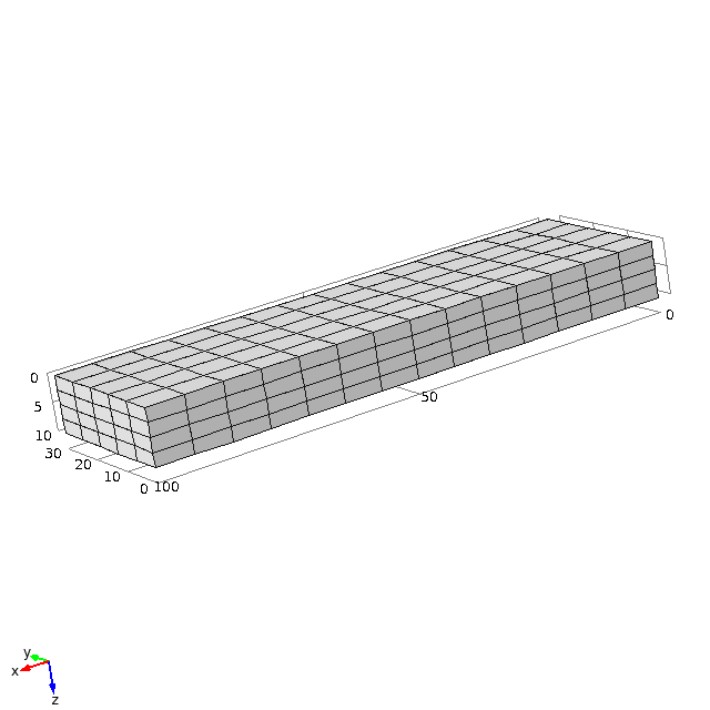

                                Sep 9, 2011, 11:24 a.m. EDT
                                                    I had a quick look at your model file and it looks like given the values of the material properties and time span you selected you have extremely thin thermal boundary layers that simply cannot be resolved by these meshes. You'd need a mesh with much finer elements along the boundaries to arrive at a solution that's reasonably close to the analytical solution.
