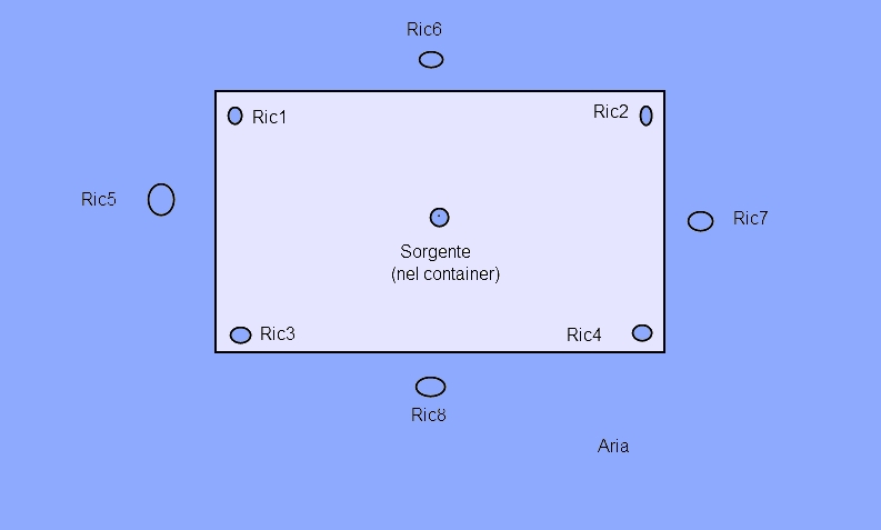

Hello, i'm using Comsol 4.2a to simulate a 2D scenario with an air-filled room (10x5) meters, with a boundary PML region (1 m of thickness on the four sides). Into this region i've inserted a rectangular Steel box (6x2,5) meters with a 5mm of thickness.
The box is air filled too. Inside the box i've created a power point source (frequency domain analisys).
In this scenario i want to evaluate the Transmission loss, between the pressure inside the box and the pressure outside of it. In future i want to misurate the displacement of the steel structure and the acceleration of the material.
I have a convergence issue when i simulate this scenario at low frequencies (2-50 Hz) and this issue remains at certain frequencies.
How can i simulate this environment ad infrasound frequencies?
I've attached a Jpeg file with a rudimental image of the scenario.
