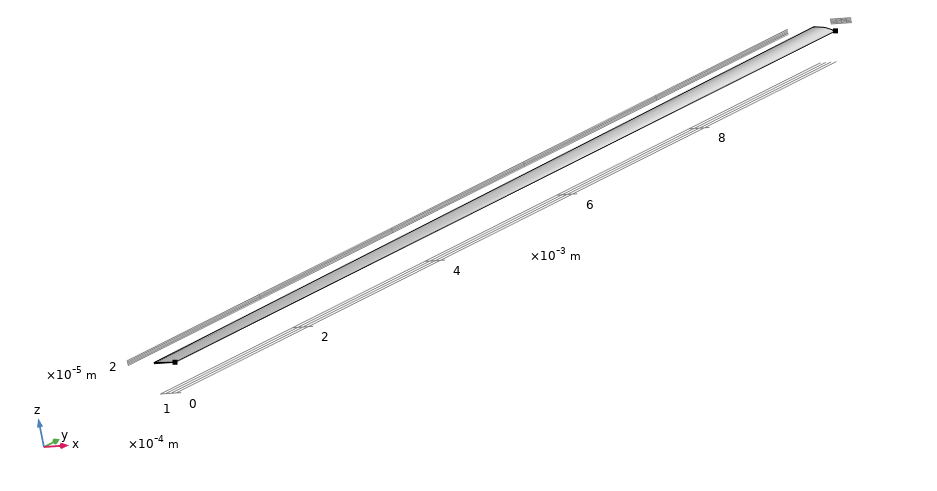

Model Setup & Geometry:

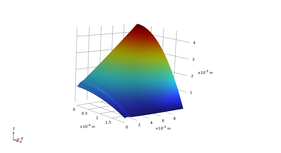

  • Domain: A 3D rectangular footprint (L1xL2). The bottom surface is flat, but the top surface has a spatially varying height profile z(x,y) that tapers down toward the edges
  • Physics: 3D Single-Phase Laminar Flow (Stationary).
Boundary Conditions:
  • Bottom (z=0): Slip wall.
  • Side 1 (x=0): Symetry.
  • Side 2 (y=0): Slip wall.

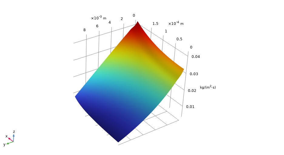

  • Top Surface: Inlet with a spatially varying, pointwise prescribed mass flux
  • Outlet 1 (x=L1): Static Pressure = 0 Pa.
  • Outlet 2 (y=L2): Constant mass flow rate.

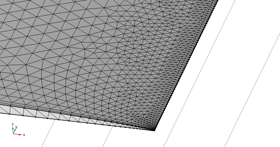

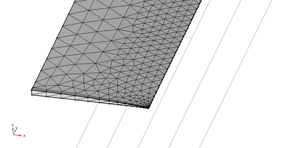

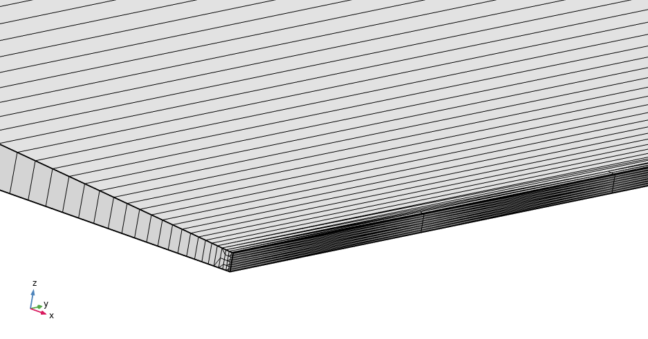

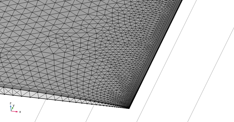

Mesh: Physics-controlled and User-controlled mesh.

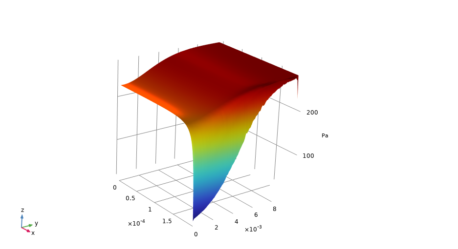

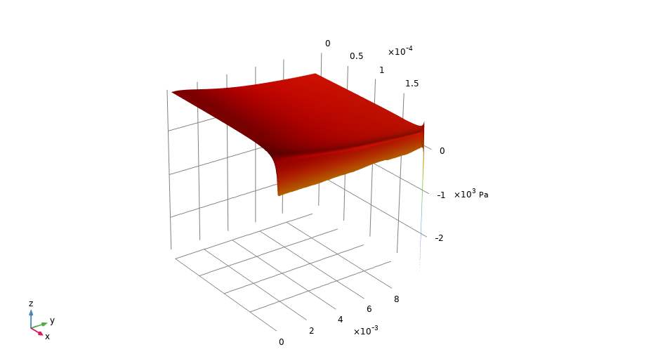

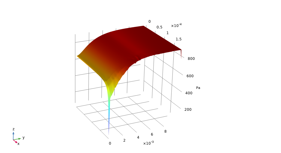

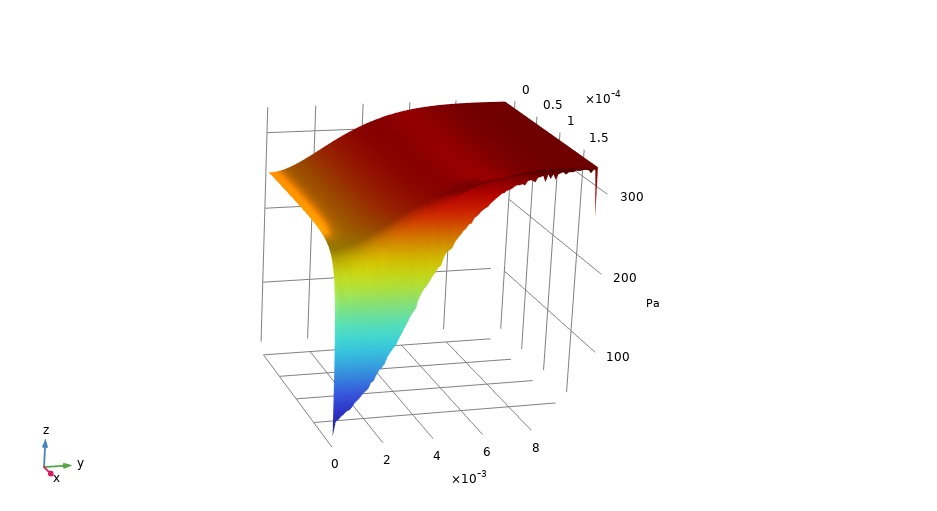

The Problem: As you can see in the attached pressure field plot, the solver converges, but the resulting pressure field at z=0 is mathematically highly unstable. Resulting pressure significantly changes when mesh is changed
  1. There is a massive negative pressure singularity at the corners of (L1,0) and (L1,L2) where.
  2. There are significant numerical ripples propagating along the boundaries, especially near the P=0 outlet.
What should I do to overcome this problem and obtain smooth pressure field?
I have attached screenshots of my geometry, top surface profile, applied mass flux and resulting pressure field for different meshes.
