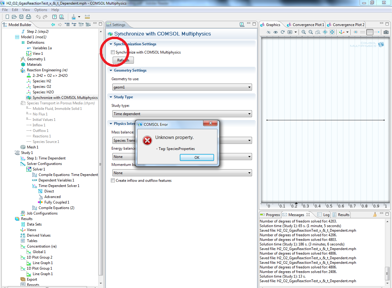

But I want this to happen inside a porous reactor, in the gas phase. So I made 'Species Transport in Porous Media (chpm)' and I can model flow of species through the medium, also fine. But when I try to model every element as a CSTR, using the chemical engineering module to calculate the reaction, it does not work.
First of all, I don't really understand how to couple the concentrations. (re) uses H2, O2 and H2O, but (chpm) uses c_H2, c_O2, c_H2O, how do the two understand this is the same? Also, when I try to couple the two using 'Synchronize with COMSOL Physics' I get a really vague error (see picture).
In words: Unknown Property Tag:SpeciesProperties, But it doesn't say what property!

1 reactor volume is defined as Vr/resolution (total reactor volume/number of elements) , that is the plan. Currently I multiplied with the resolution again, so the reaction volume is now just 1 m^3 again in the attached model.
