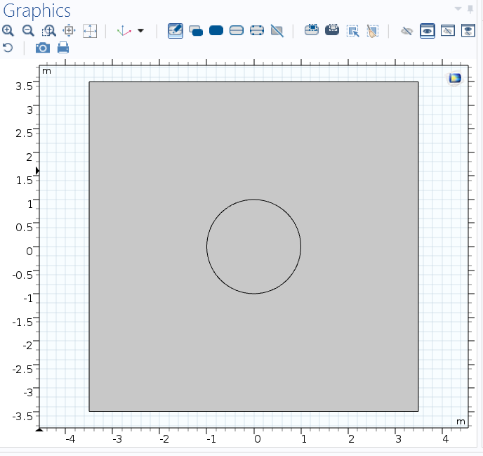

i'd like to do a 2D simulation with laminar flow and heat transfer in solid physics, but i have a problem. I have to do a square within flow the air at a temperature of 100K (inlet: left - outlet: right) and, in the middle of the square, a circle of copper (like heat source). At the bottom of the square I set a temperature of 288.15K. When I simulate, the temperature of all domain is done by the circle of copper that are heating, but the air that flows in the square doesn't influence the temperature of the domain (also if the temperature of the air is very low). Someone can help me, please? Thank you!
