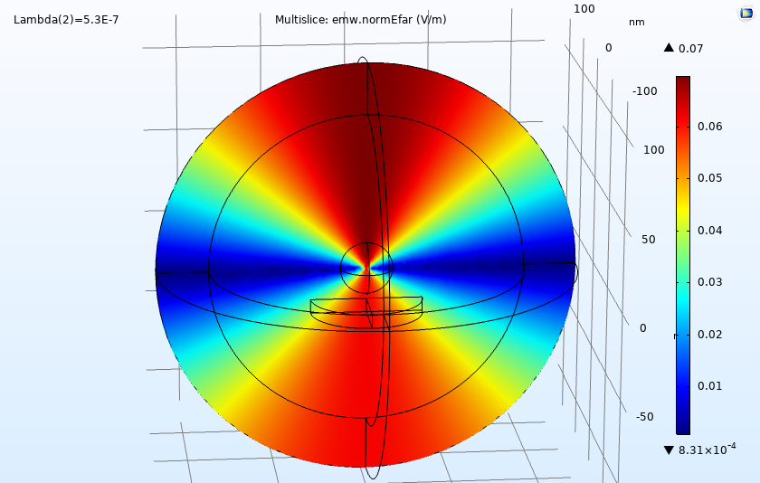

Thanks alot for your reply. I'm interested in the total power scattered to the far field. I made a typo error in the expression in my previous power.. I meant it is ewfd.(normEfar^2)/(2Z0const)
At what distance should I make the surface integration? The variable normEfar is calculated in comsol at 1[m] so I think it is constant with the distance..it only differs with the angle as shown in the attached figure.. so why my result differ when I integrate over closed surfaces with different radius?
>You can simply integrate the Poynting vector over a closed surface. Thanks alot for your reply. I'm interested in the total power scattered to the far field. I made a typo error in the expression in my previous power.. I meant it is ewfd.(normEfar^2)/(2Z0const) At what distance should I make the surface integration? The variable normEfar is calculated in comsol at 1[m] so I think it is constant with the distance..it only differs with the angle as shown in the attached figure.. so why my result differ when I integrate over closed surfaces with different radius?

Energy conservation ensures one can calculate the power in the near field. Or maybe you are interested in more than the final result?
