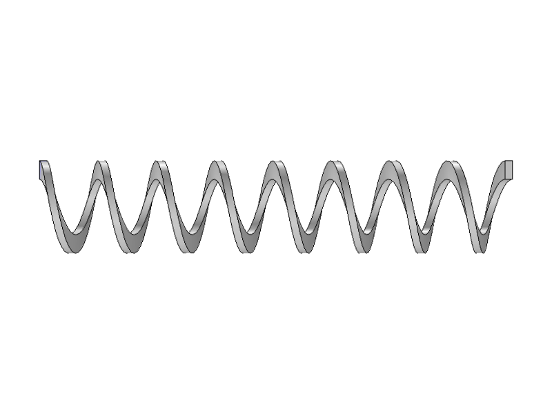

I need to know how to make a helical ribbon with rectangular cross-section.

Is this what you want? I made it by sweep a rectangle with a helix. If yes, I can upload the model.

yes, is exactly that I need.

Sorry for that. Below is how I made it.
First is create a rectangular in a work plane.
Second, make a parametric curve to represent the helix curve, like (cos(4*s),sin(4*s),s).
Last, sweep the rectangular with parametric curve. Pay attention to uncheck the "twist compensation".

But I have other problem, i cant do difference between a cylinder and the agitator because disappears the figure.
I tried make a difference with each element and I realized that it can be for the sweep. I m not sure, have you any idea.

I am having the same issue. Anytime I perform Boolean operations on an object created with sweep I get funny results - I think the surface normals are getting reversed on some of the faces. I sent a message into support, I'll post any fixes they are able to suggest.
