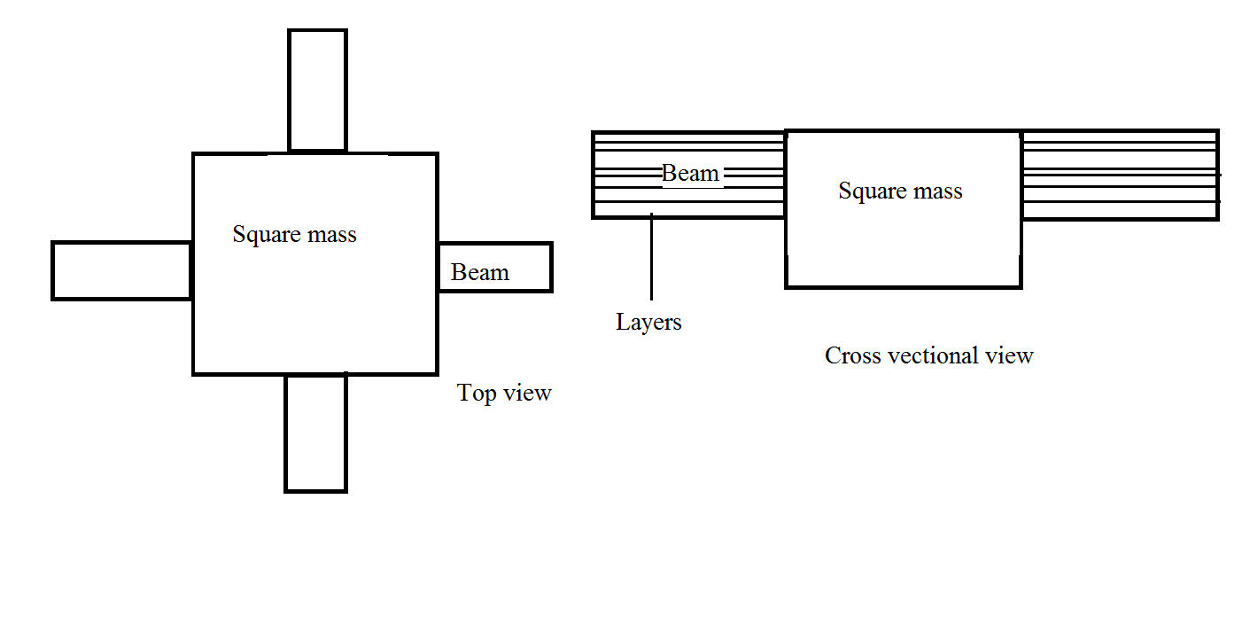

Looks like meshing is a real 'art'. I have attached schematics of my model. All the layers in the beams are attached to the square mass. I tried meshing (sweep) the square first and then meshing the layered beams. No luck.
Tried sweeping layers, converted them and then meshing square mass (both sweep and tetrahedral). Did not work.
Tried to sweep from sides and then meshing the square mass. Did not work either!!
Is there anything left to be tried?
Thanks
Sankha
are your x-y scales isotropic or are the beams very thin ?, one way would be to cut the square at the height of the lower beam boundary, mesh the beams with tri on top and sweep through, then convert the surfaces = boundaries como to the upper square and try toget that one into a fine thet, you should allow for small mesh, reduce the minimum size to about the value of the smallest mesh in the beam section. Thereafter you mes the lower part of the square with a normal thet mesh.
Another way that works 100% but generates very man mesh elements, is to cut the square block along all the layers of your beams, so you have a full transverse "lasagne" plate there (hope you know italian cuisine ;) then you can mesh the full top surface with tri and sweep through the rest of your parts all the way down. You might want to add several dimensions and ensure you have a few layer per layer thickness
I tried to cut the square mass into layers and sweep meshed top 7 layers (which are in contact with the beams) along with the layers of the beams. It worked fine. So, now the only layer left to mesh is the bottom most layer of the square mass. To do this, I first tried sweep mesh. Then I converted the layer in the square mass which is in contact with this layer and use tetrahedral meshing, but that did not work either. I think I am missing something here. Why can't I mesh this layer? This layer is not in contact with the beams!! It's in contact with the square mass only.
When I tried sweep mesh this layer from side, the error was " Failed to copy mesh between edges, from the source face to destination face". When I tried to mesh from bottom surface, the error was "Mesh on source and destination face do not match". Does this have to do with mesh size?
Thickness of the square mass is 5 micron. Beams are 3.3 microns thick. The length of the square mass is 500 microns. The length of the beams is 250 micron and width is 120 micron.
