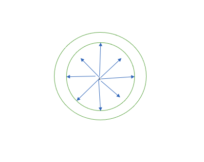

Apply outward radial pressure of same magnitude on a inner 2D ring
I would like to investigate the relation between the pressure and the diameter of a 2D ring configuration. As shown in this picture, I would like to apply the radial pressure with the same magnitude to the inner surface of the 2D ring structure, but there seems to be only loading in x or y direction that can be applied to the structure. My question is that how to apply the radial pressure to the inner surface of a 2D ring structure?
I will very appreciate anyone could help that! Best wishes Ricky

There are several ways to do this.
Easiest: one of the options under Boundary Load is...pressure.
Next (if no large displacements): write it out in terms of components.
Another option: use surface normals.
There are several ways to do this. Easiest: one of the options under Boundary Load is...pressure. Next (if no large displacements): write it out in terms of components. Another option: use surface normals.
