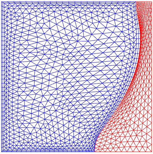

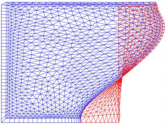

Hi All,
I am learning the case of tin_melting_front which demonstrates how to model phase transition by a moving boundary interface according to the Stefan problem. This is a very good case with well desgined boundary conditions. But I found that when simulating all solids disappear, there will be a problem. As all solid phase disappears, the Phase Change Interface would crosss the model boundary. This is impossible in real situation.
How to deal with such a situation?
Thanks!
