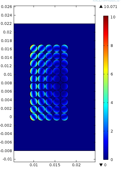

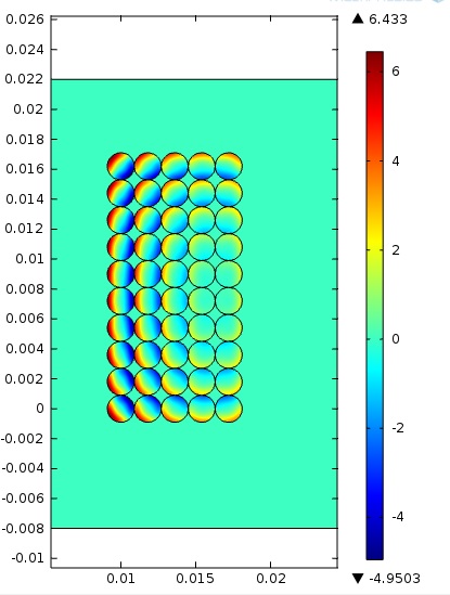

Hi, i'd like to know the relation between the quantities normJ and the components of the vector J (Jr, Jphi, Jz). I have simulated a coil group domain driven by a current of 10A.
The components Jr and Jz are equal to zero. So the vector J should be J=(0,Jphi,0)
A vector norm in 3D is defined as norm(v)=sqrt(v1^2+v2^2+v3^2), i.e. the square root of the sum of the norm of its components. In the above mentioned case, I would expect normJ and the Jphi component to have the same value, but it doesn't happen.
Unfortunately I cannot find any explanation of the relation of these current density quantities in the documentation set. If somebody could enlight my mind, this would be much appreciated.
