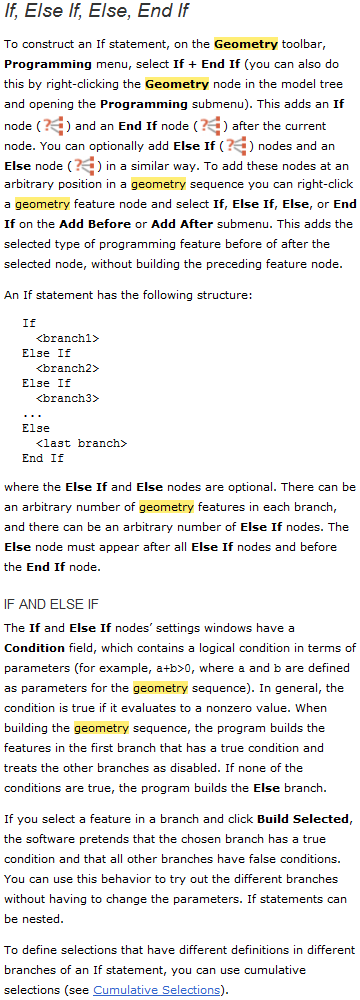

Does anyone know where to find a tutorial or an example on how to use If/Else statements to define conditional geometries in the model tree? I have read all about the new feature with version 4.4 however I can't find any tutorials of it. Thank you in advance for any help!

Thank you for your quick response! Perhaps this is what you are trying to show me with the domino.mph file, but I am trying to define a geometry based on a conditional statement as explained in the help documentation which is shown in the attached image. If that's what you gave me sorry for not understanding it better (I'm quite new to COMSOL still). What would be awesome is a tutorial of sorts to understand how to use the feature. Again, thank you for your help!
