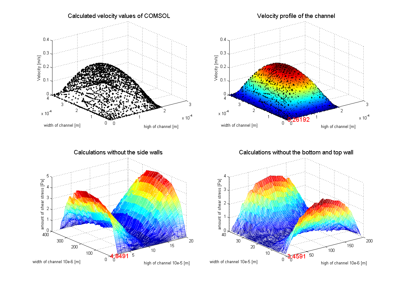

The equation you are talking about is good for two dimensional calculations along the velocity profile. Do you have a 2D or a 3D model?
If you have a 3D model you can extract one velocity slice and do further calculations in matlab. I calculated the shear stress along the X and Y axis, one result is attached. Of course, this result is partly wrong because only the effect of 2 of the 4 walls is noted. But I think that the calculations are good directly at the middle of the involved walls, because there is less effect of the other walls. As further as you go to the edges or in the middle of the channel, the effect of the not noted walls increases and the results get huge error. But this could be a way to get your maximum shear stress values with a small error because the maximum values should be located in the middle of each wall.
The minimum value I am not quite sure about, but assuming laminar flow (micro fluidic) there should be no stress in the middle of the channel, but I will double check that.
I still look for a way to visualize the overall shear stress profile in comsol, or a way how I can combine the results I created in matlab. I am thankful for any help.
T. Gumbel

                                                    Hi Tyler
Regarding your answer I have a question. Is it allowed to just sum up the stress????
You mention that for 2D cases you use eta*(uy+vx). So if that is right, for 3D cases the formula
eat*abs(vx) + eat*abs(uy) + eat*abs(wz)
would be right as well????
I just implemented it in comsol with the result I added (first two pics).
The velocity profile looks fine. The shear stress not really. The stress values at the bottom and top wall are acceptable but the stress on the sidewalls is wrong I think.
So if I sum up all components
eta0*abs(vy) +eta0*abs(uy) +eta0*abs(wy) …
+ eta0*abs(vx) +eta0*abs(ux) +eta0*abs(wx) …
+ eta0*abs(vz) +eta0*abs(uz) +eta0*abs(wz)
the third profile is calculated, but I am not sure whether summing up all individual results is allowed?
Do you have any advice?
Thanks for any further help.
T. Gumbel

                                                    I'm glad you found my answer somewhat helpful. Let me clarify, first. I'm not just adding the stress terms; rather the value ( uy+vx) is actually a single component in the tensor matrix I calculate. I suppose it depends on your definition of the stress tensor. Because I'm using a symmetric tensor definition (assumes no spin and is coordinate reference independent -- at least this is what I've been told), my two non-diagonal elements are the same. With a nonsymmetric definition of the stress tensor, tau=viscosity*grad(U), the non-diagonal elements will be different. Honestly, I'm unsure which is the most appropriate, but the best I can offer is this regarding symmetric/non-symmetric definitions:
"This velocity gradient tensor is not exactly similar to the stress tensor in that the velocity gradient tensor is not symmetric, if you transpose rows and columns you will have something totally different. The physical interpretation of this is that the velocity gradient measures not only the deformation of the fluid body (by compression and/or shearing), but also the relative orientation of the fluid body (rotation). When I’ll have some more time, I will demonstrate this. Therefore, we cannot write a direct mathematical relationship between stress tensor (tau) and velocity gradient (grad(U)) since the stress tensor doesn’t care at all of the rotation of the body, which has nothing to do with pure deformation. However, the velocity gradient tensor like any similar tensor can be broken into two parts, one symmetric (D) and the other one, antisymmetric (S)."
www.granular-volcano-group.org/viscous_stress.html
The symmetric part of the velocity gradient tensor is used for the stress tensor (tau=2*visc*D).
At any rate, back to your question: I don't think it's appropriate to simply add the non-diagonal components of the 3D tensor. My guess is that you want a magnitude rather than a simple sum. Something like the square root of the sum of the squares would make more sense, but again, I'm not for sure. I've heard some people refer to this as a simple "shear modulus", which seems to be another word for magnitude in this case. The only other idea I have is that you may only be concerned with the maximum of any of the shear elements -- maybe their combination doesn't matter, and you only care about the max?
Hope this is helpful, I'm still learning about this myself. Please let me know if you find any clear answers!
