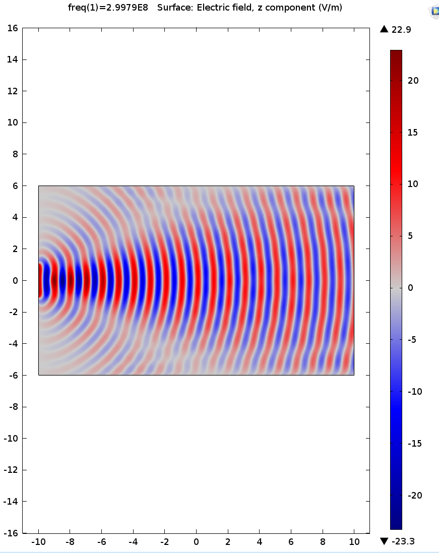

Hi, I am quite new to comsol. My problem is fairly simple. I want to simulate an incident plane wave in 2D using RF module and calculate Fresnel Reflection and Transmission coefficients.
However, I am not sure to setup a plane wave travelling in x-direction. I used exp(-i*k*x) in port settings and chose E-field as input.
I have used a rectangular geometry and setup a port. But I am getting a Gaussian wave rather than a plane wave.
Help would be much appreciated.

Consider making your port the whole left end rather than just that little bit in the middle. Also exp(j*k*x) is a constant (1) at x=0, which is everywhere in your port on the left end.
