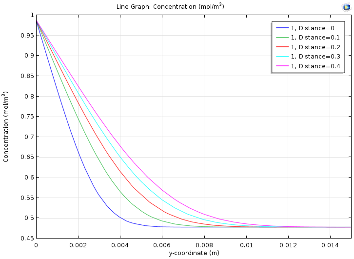

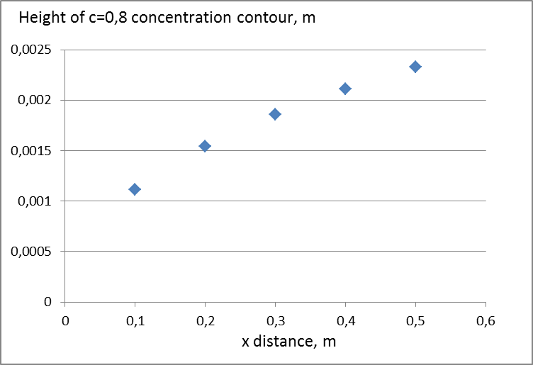

For a sledgehammer approach I try defining in DataSets a 2D Cut Line, vertical at a series of x positions. Then made a 1D plot group with a 1D line graph that graphed the concentration on each x-value for the Cut Line. All these curves come on the same plot, which you then can export the data from (helps to select "sort" under Advanced). I imported the data into excel and used the Forecast linear interpolation to determine the y-coordinate height at which the concentration was 0,8. Looked pretty linear in the region of c=0,8, but otherwise it is just to plot and fit a trendline and interpolate with the equation. Attached the 2D cut line plot (c vs y for different x) and the resulting BL growth plot (of y for c=0,8 vs x) from Excel. A real pain to have to do this manually, so hope someone comes with the elegant solution.
