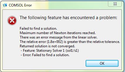

My question is, I cannot get a solution from this module, the comsol error informing that "Failed to find a solution. Maximum number of Newton iterations reached." I tried to increase the iteration number, but it seems it cannot figure out this problem perfectly.
