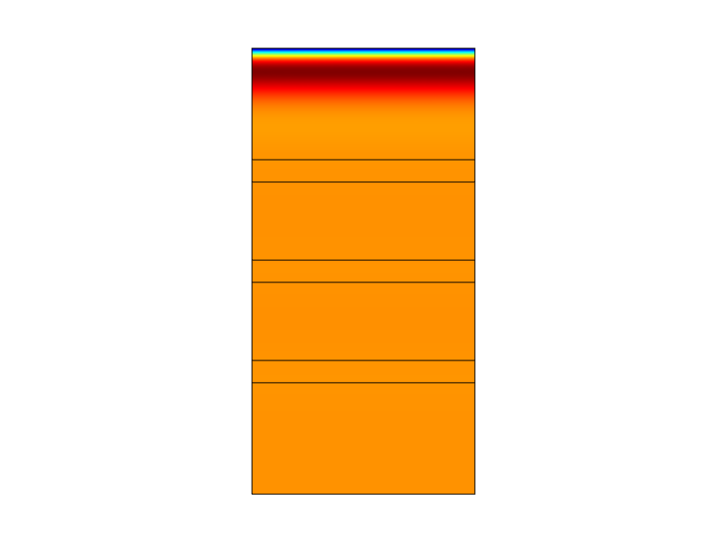

I have a problem in the PML/port configuration for the calculation of Transmittance.
I don't understand why in my model (attached), despite the unitary imput power at port 1, the integration on the middle line of the sample turns in a value different than one, and the integration on the port 1 line gives me NaN.
Anyone one can help me?
Thanks,
G,.P.

I just slightly modified your previous model by changing port BC to two scattering BC (on the top and bottom) so that you can excite a plane wave from top to bottom through two PMLs. Particularly, I put a dielectric layer in the air domain with n=2 (SiN) and probe the powerout flow along one boundary near bottom PML. It looks like this model now works well. FYR.

I see your modified configuration to my model.As result I see a surface plot where the field is overall zero except close the top PML (becouse it has been absorbed, i suppose).It don't seem to work well, I mean i don't see the field inside the domains.I want a configuration (PML+Port was the best case in previous versions) for witch i can excite a plane wave in the interior domains and it can be scattered by any possible scattering object inside them.I need the PML on top and above side in order to absorbe any scattered component of the wave.
