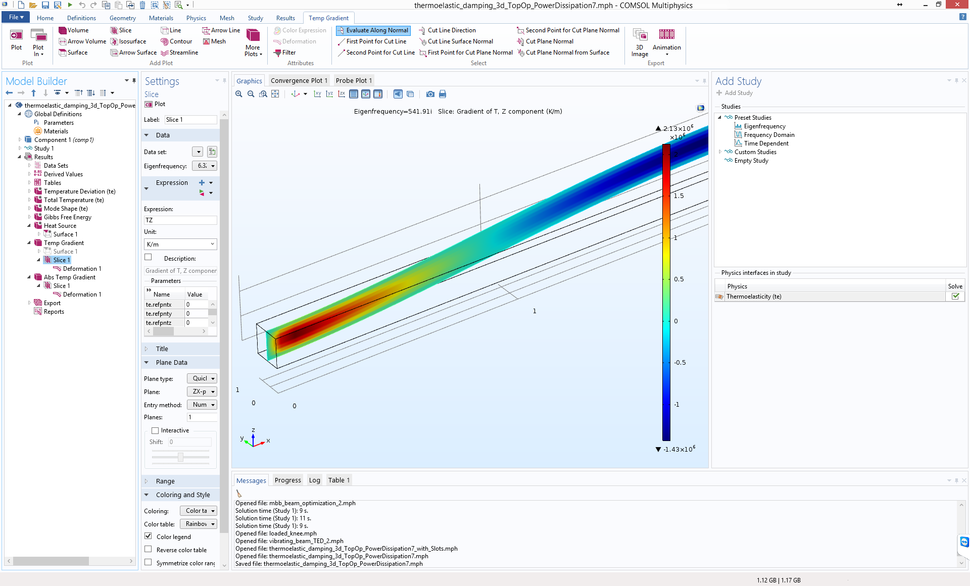

I take the gradient of T in the Z direction using the command TZ. I want to be able to get the absolute value of this at each phase of oscillation but when I use the command abs(TZ) it seems to give me the integral of |TZ(t)| over one period of oscillation. Compare 'Player 2' vs 'Player 3'. The values in 'Player 3' are constant during oscillation but I want the absolute value of the values from 'Player 2' at each phase.
How can I get TZ(t) at each time t?
I attached two images and the .mph model.

TZ is complex valued. What you see when you plot TZ is actually real(TZ) which is the actual value at the current phase angle in the cycle. When you create abs(TZ) you get the amplitude of the complex value, which is independent of the phase angle.
What I think you want to plot is abs(real(TZ)). This will give you the absolute value of the results at each phase angle.
Not that for the ordinary slice plot, you can enter the phase angle at which you examine the results in the settings for the data set.
