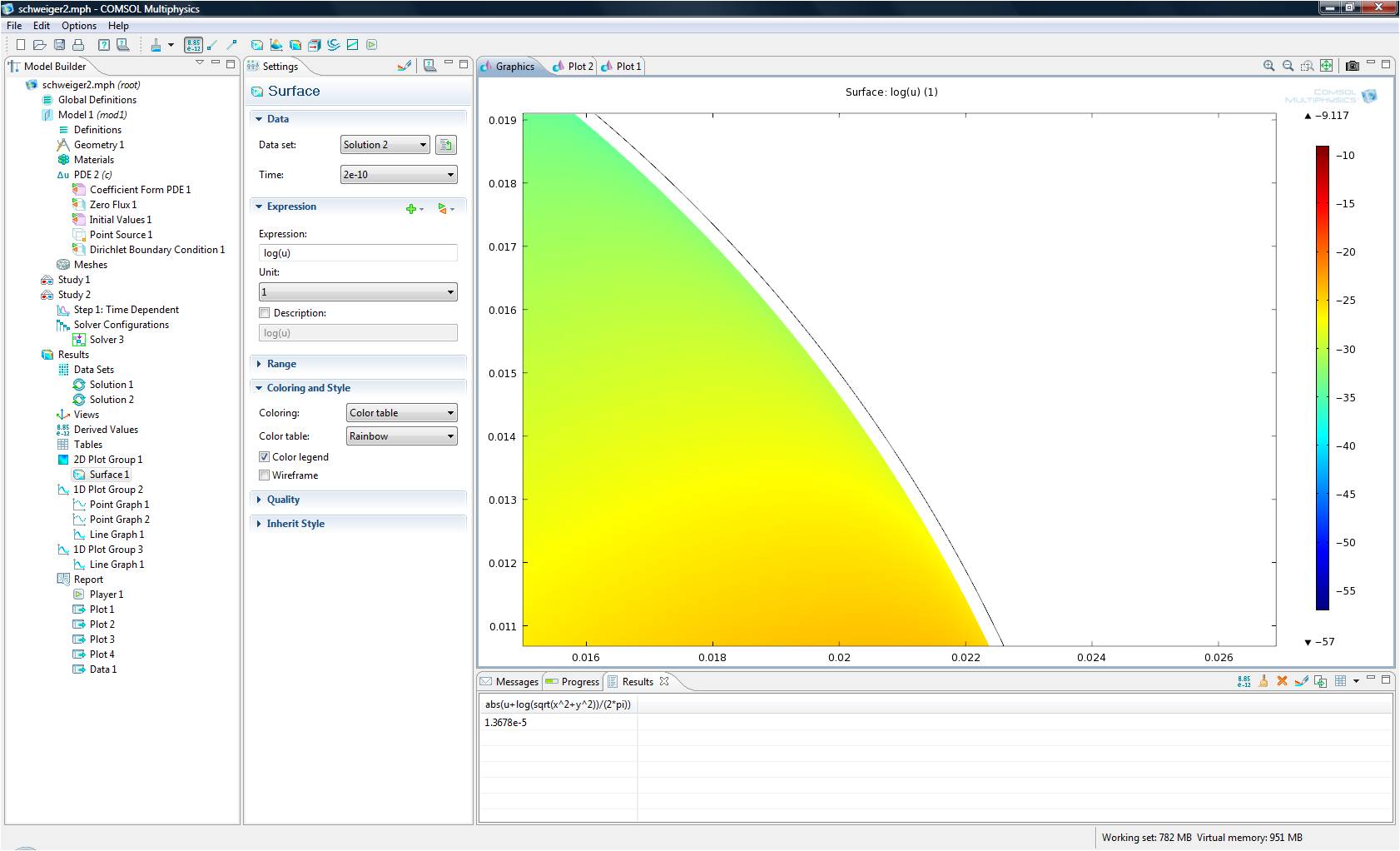

Attached is a screen shot. I would attach my model but it's 80MB for some strange reason.

About your question, it looks like a postprocessing error.
It would be better to see the model file.

There is no valid value to plot near the boundary because you are plotting log(u) where u is equal or close to zero, and log(0) is undefined. Try plotting log(u+eps), for example, where eps is a small number representing the machine precision. In COMSOL Multiphysics the plot is empty where the data is undefined or "not-a-number."
