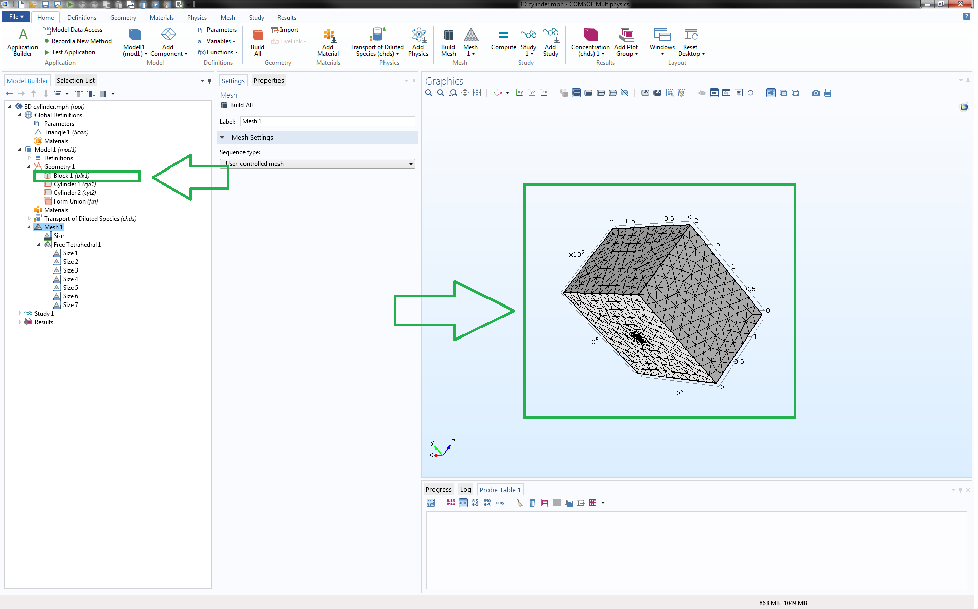

Even if you replaced that block with a cylinder your model would still not be axisymmetric due to the non-axisymmetric boundary conditions.
Jeff
Actually it is a cylindrical geometry. That parallelepiped shape is due to the mesh, since I had to deleted the meshes to send the file. If you please either check the geometry 1 or if you build all meshes you will see the cylindrical geometry.
Thanks
Jeff

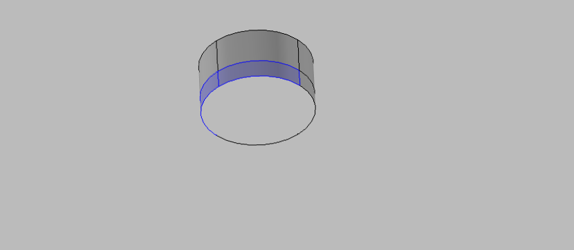

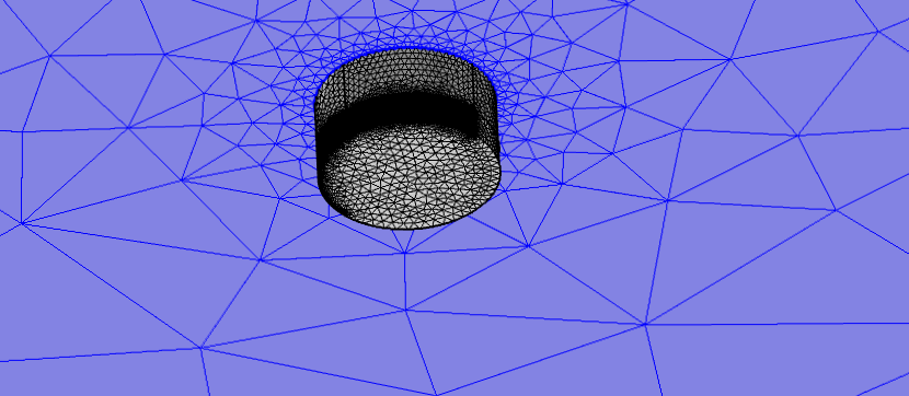

Oh I see, sorry, that block is the domain. Actually I am simulating a recessed cylinder ( r= 250 nm). The whole model consists of: a big block as domain and two recessed cylinder. I am interested in the second cylinder and I solving the problem for half it. Please see the zoom in screenshots.
