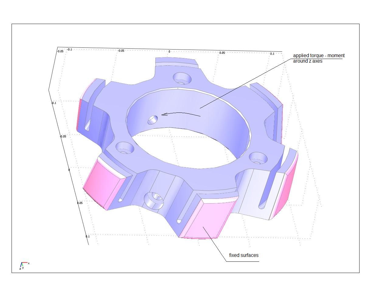

torque load
I try to model a ring blocked in the external cylinder. I want to apply the torque on internal surface and fixe external surface (see picture). But in the Multiphysics Structural , solid stress-strain analysis you can apply only load (force) or displacements(Rx, Ry). So, I've calculated a rotations (correspondant to the torque) then displacents Rx, Ry and applied int the boundary. After run the VM stress are too high and the reactive torque on the fixed surfaces is 1000 more than I considered to apply.
Do somebody used the Comsol for the torque load simulation. Please advise. Thank you very much.

You can find a very nice example in the SMEUG.pdf file EXAMPLE: Torsional moment on a cylinder. With all explanations how to apply it, I would suggest to try out the example first.
As rotations are not defined by default in 3D structural, you need to work a little with coordinate transforms, but it works very well.
Hi You can find a very nice example in the SMEUG.pdf file EXAMPLE: Torsional moment on a cylinder. With all explanations how to apply it, I would suggest to try out the example first. As rotations are not defined by default in 3D structural, you need to work a little with coordinate transforms, but it works very well. Good luck Ivar

Thank you for your reply. I've calculated the transformation from the angle of rotation to the coordinate change. I've tested it in Excel firstly and in the Comsol I've got the same displpacements like in Excel. But in Comsol I've got the irrealistique stresses.
I'll looking for this exemple. Thank you Ivar.
Thank you for your reply. I've calculated the transformation from the angle of rotation to the coordinate change. I've tested it in Excel firstly and in the Comsol I've got the same displpacements like in Excel. But in Comsol I've got the irrealistique stresses. I'll looking for this exemple. Thank you Ivar.

Posted: 2 decades ago Oct 6, 2009, 7:15 a.m. EDT
Sorry the SMEUG.PDF is the "Structural Mechanics Module, User's Guide", see page of V3.5a page 69++ or just scan for "Torsional". For me its in .../comsol35a/doc/sme/
I have indexed all my helpfiles and pdf manuals with MS indexer, it's then easyer to find items there, but there is also the help files with a search function
Hi Sorry the SMEUG.PDF is the "Structural Mechanics Module, User's Guide", see page of V3.5a page 69++ or just scan for "Torsional". For me its in .../comsol35a/doc/sme/ I have indexed all my helpfiles and pdf manuals with MS indexer, it's then easyer to find items there, but there is also the help files with a search function

Posted: 2 decades ago Oct 6, 2009, 10:29 a.m. EDT
If you are going to do a lot of structural as I can see on your image, you should very seriously consider the purchase of the structural module, you will quickly gain time covering the price difference
I hope the explanation below works ok without, but as I understand it there is not much specific to the structural module.
And I hope COMSOL finds it OK to export an excerb of their doc, if not, they know how to suppress it ;)
By the way, some of these docs can also be found on the web with a Google search, albeit I find that less conform to normal (c) standards
Hi If you are going to do a lot of structural as I can see on your image, you should very seriously consider the purchase of the structural module, you will quickly gain time covering the price difference . I hope the explanation below works ok without, but as I understand it there is not much specific to the structural module. And I hope COMSOL finds it OK to export an excerb of their doc, if not, they know how to suppress it ;) By the way, some of these docs can also be found on the web with a Google search, albeit I find that less conform to normal (c) standards Good luck Ivar

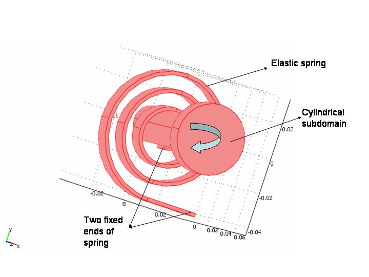

Posted: 2 decades ago Jan 23, 2010, 5:47 a.m. EST
hello Ivar,
I had gone through the discussion. Iam having one doubt in similar to it. Iam doing a module in comsol on concept of winding and unwinding a elastic spiral spring w.r.t a cylindrical rod in middle of the spring.
Now i want to rotate the rod spherically, so that the spring should wind and unwind.
Here i fixed the two ends of the spring and tried normally in cartesian coordinates. Output obtained is just moving the rod in one direction .
I require information in rotating rod spherically.
pls do the needful help.
Thanking you..
hello Ivar, I had gone through the discussion. Iam having one doubt in similar to it. Iam doing a module in comsol on concept of winding and unwinding a elastic spiral spring w.r.t a cylindrical rod in middle of the spring. Now i want to rotate the rod spherically, so that the spring should wind and unwind. Here i fixed the two ends of the spring and tried normally in cartesian coordinates. Output obtained is just moving the rod in one direction . I require information in rotating rod spherically. pls do the needful help. Thanking you..

Posted: 2 decades ago Jan 27, 2010, 7:50 a.m. EST
Thank u for reply.Iam not getting in correct way to do the model so
I attached my geometrical model here, that is in 3D space dimension .
The two ends of elasticspring are fixed by using holes kept on it. In middle of the spring a cylindrical subdomain is added.
Now the subdomain should rotate with the axis of rotation, and due to that there should be deformation in the spring(strain calculation due to angulardisplacement) i.e, spring winds and unwinds.
This is my problem. I didnt understand how to do this process(analysing) in Comsol.
I followed comsol multiphysics-structural mechanics-solid-stress/strain-static analysis.
I request u to send an idea how to do this process.
Hi, Thank u for reply.Iam not getting in correct way to do the model so I attached my geometrical model here, that is in 3D space dimension . The two ends of elasticspring are fixed by using holes kept on it. In middle of the spring a cylindrical subdomain is added. Now the subdomain should rotate with the axis of rotation, and due to that there should be deformation in the spring(strain calculation due to angulardisplacement) i.e, spring winds and unwinds. This is my problem. I didnt understand how to do this process(analysing) in Comsol. I followed comsol multiphysics-structural mechanics-solid-stress/strain-static analysis. I request u to send an idea how to do this process.
Posted: 2 decades ago Jan 27, 2010, 5:01 p.m. EST
Well basically a whatchmakers spiral and the momentum wheel.
For me it applies well to the SMEUG.PDF example (the "Structural Mechanics Module, User's Guide", see page of V3.5a page 69++ or just scan for "Torsional". For me its in .../comsol35a/doc/sme/).
I agree that the explanations are not crystal clear, and I still have a unit issue I'm not happy with (at least in V3.5a, when I follow the explanations literally) but the rotation is there when I model it, even if I cannot yet get the reaction moment to match my applied moment.
One of the items is that the "cylindrical coordinate" check used to define the new user coordinate system generates a specific rotation matrix (dump your model as a M file and check the coordinate section) that does the trick, the "geom2" workplane is only there as a placeholder to access this option for the new corrdinate transform.
If you want to force and fix the rotation axis, then I would suggest to add two points along the axis on the top/bottom surface of your shaft, and enforce a displacement Rx=0 Ry=0 Rz=0 on both points. It's slightly crude as a "point constraint" but works still quite well.
Hi Well basically a whatchmakers spiral and the momentum wheel. For me it applies well to the SMEUG.PDF example (the "Structural Mechanics Module, User's Guide", see page of V3.5a page 69++ or just scan for "Torsional". For me its in .../comsol35a/doc/sme/). I agree that the explanations are not crystal clear, and I still have a unit issue I'm not happy with (at least in V3.5a, when I follow the explanations literally) but the rotation is there when I model it, even if I cannot yet get the reaction moment to match my applied moment. One of the items is that the "cylindrical coordinate" check used to define the new user coordinate system generates a specific rotation matrix (dump your model as a M file and check the coordinate section) that does the trick, the "geom2" workplane is only there as a placeholder to access this option for the new corrdinate transform. If you want to force and fix the rotation axis, then I would suggest to add two points along the axis on the top/bottom surface of your shaft, and enforce a displacement Rx=0 Ry=0 Rz=0 on both points. It's slightly crude as a "point constraint" but works still quite well. Good luck Ivar

Posted: 2 decades ago Feb 9, 2010, 5:45 a.m. EST
hello,
basically i dont how to analyse the simulation,i just know how to geometric model.
My theoritical strain formula is
According to mechanical theory of torsional springs
strain , ?=(6*J*??) /(h*b^2*l)
=(h*??)/(2*l)
??=angular displacement
J=inertial moment of transverse section of spiral torsion spring
i know values h,b,l (geometric parameters of spring)
i dont know about J
i hve to relate the obtained the simulation strain with this theoritical strain
In comsol how can we know the strain and how the the simulation strain will follow as same concept as theoritical strain
pls do needful help
thank you
hello, basically i dont how to analyse the simulation,i just know how to geometric model. My theoritical strain formula is According to mechanical theory of torsional springs strain , ?=(6*J*??) /(h*b^2*l) =(h*??)/(2*l) ??=angular displacement J=inertial moment of transverse section of spiral torsion spring i know values h,b,l (geometric parameters of spring) i dont know about J i hve to relate the obtained the simulation strain with this theoritical strain In comsol how can we know the strain and how the the simulation strain will follow as same concept as theoritical strain pls do needful help thank you

Posted: 2 decades ago Feb 18, 2010, 2:12 a.m. EST
Sorry coming in late, but I am still very busy and have had little time to go on the forum. Nevertheless,
I'll try to give some replies hereafter, as I understand from your questions:
- strain, stress calculations,: COMSOl have them internally, the trick is to get read them = postproces and to be sure you have them in the deisred coordinate refeence (by default COSOL is in cartesian x,y,z, The strain tensor (6 independent items for isotropic material) are in the Subdomain postprocessing with the names: ex,ey,ez, normal and exy, eyz, exz shear elements. Now there are other ways to work with strain (as well as stress) vlues, this depends on your domain, I can only suhggest to look into the classical books on elasticity.
Depending what you are looking for you might need to integrate these values over your domain.
Now angles of rotation, COMSOL does not inlcude angles in 3D smsld, I have discusseed that a couple of times with the people of support and the developpers when I meet tham at the conferences, one of the issues is that the conventional angle value is only really valid for "small" angles, and the non-linear ode of COMSOL allos you to simulate large angles and then these "small" angles values are really no longer correct.
In your case with your spiral spring you are somwhere in the middle towards the "large angle" approach so pls be aware.
If you read through chapter 2 of the excelent short book:
www.amazon.com/Elasticity-Tensor-Dyadic-Engineering-Approaches/dp/0486669580/ref=sr_1_2?ie=UTF8&s=books&qid=1266476488&sr=8-2
see also the thread "breathing eigenmode of a 3D solid sphere"
you will see that you can define the "small" angles as
thu = 0.5*(wy-vz)
thv = 0.5*(uz-wx)
thw = 0.5*(vx-uy)
It's the antisymmetric, or curl part of the general displacement formulation shown hereafter in 2D:
du = (du/dx)*dx + 1/2*(du/dy + dv/dx)*dy + 1/2*(du/dy - dv/dx)*dy
or
du = ex*dx+1/2*exy*dy-thz*dy
You can recognise the normal and shear strain and the "rigid body" rotation thz
I hope this will help you on your way

there are a few threads on the forum about torque load an torsional moments, and in the structural documentation smeug.pdf there is a good example, I needed some tries before I catched the "trick" but it works fine for me
try "torsional moment" in the search above
Hi there are a few threads on the forum about torque load an torsional moments, and in the structural documentation smeug.pdf there is a good example, I needed some tries before I catched the "trick" but it works fine for me try "torsional moment" in the search above Good luck Ivar

Posted: 1 decade ago Jun 10, 2014, 3:45 p.m. EDT
Dear Ivar
I was trying to reproduce the "Torsional moment on a cylinder" example in version 4
As I understood the moment is expressed in terms of stress distribution at boundary surfaces as
M=int(Taz_smsld*y-Tay_smsld*z) Where the value of M is set to 100
and tau is defined as
tau=M-100
What I dont understand is what is the need to add "tau*r" as boundary load? . If M is set to 100 then tau goes 0 !
H.
Dear Ivar I was trying to reproduce the "Torsional moment on a cylinder" example in version 4 As I understood the moment is expressed in terms of stress distribution at boundary surfaces as M=int(Taz_smsld*y-Tay_smsld*z) Where the value of M is set to 100 and tau is defined as tau=M-100 What I dont understand is what is the need to add "tau*r" as boundary load? . If M is set to 100 then tau goes 0 ! Regards, H.
