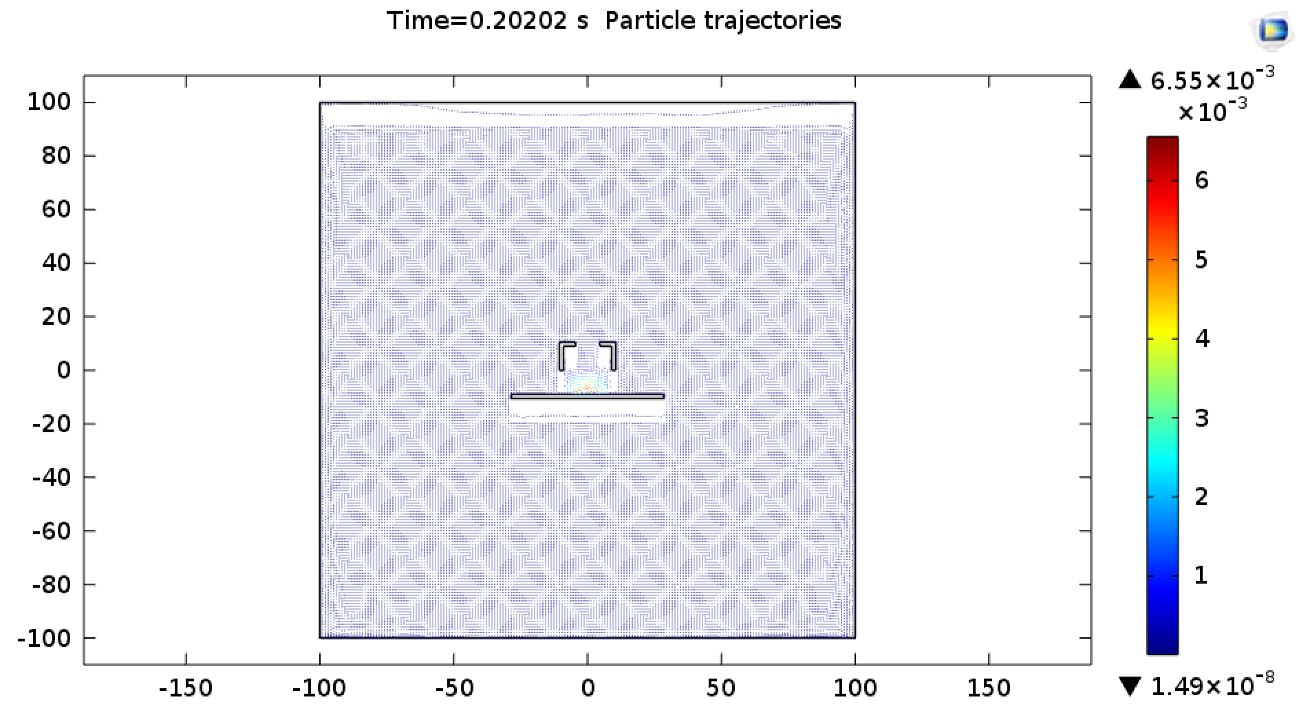

I am simulating a 2-D Model, where I want to analyze the convection effect of a heater which is heating up the air above. I want to see the effect of particles, that are distributed in the air. I separated the problem into 2 studies.
1. Study: Analysis of laminar flow and heat transfer
2. Study: Particle tracing for fluid flow

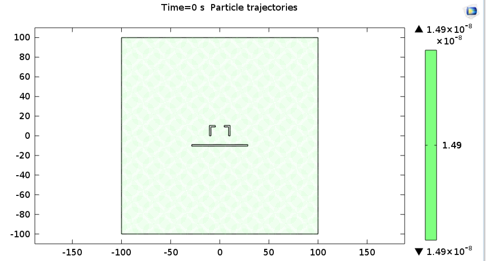

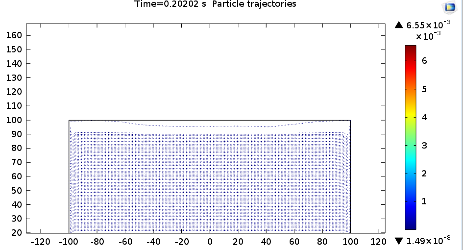

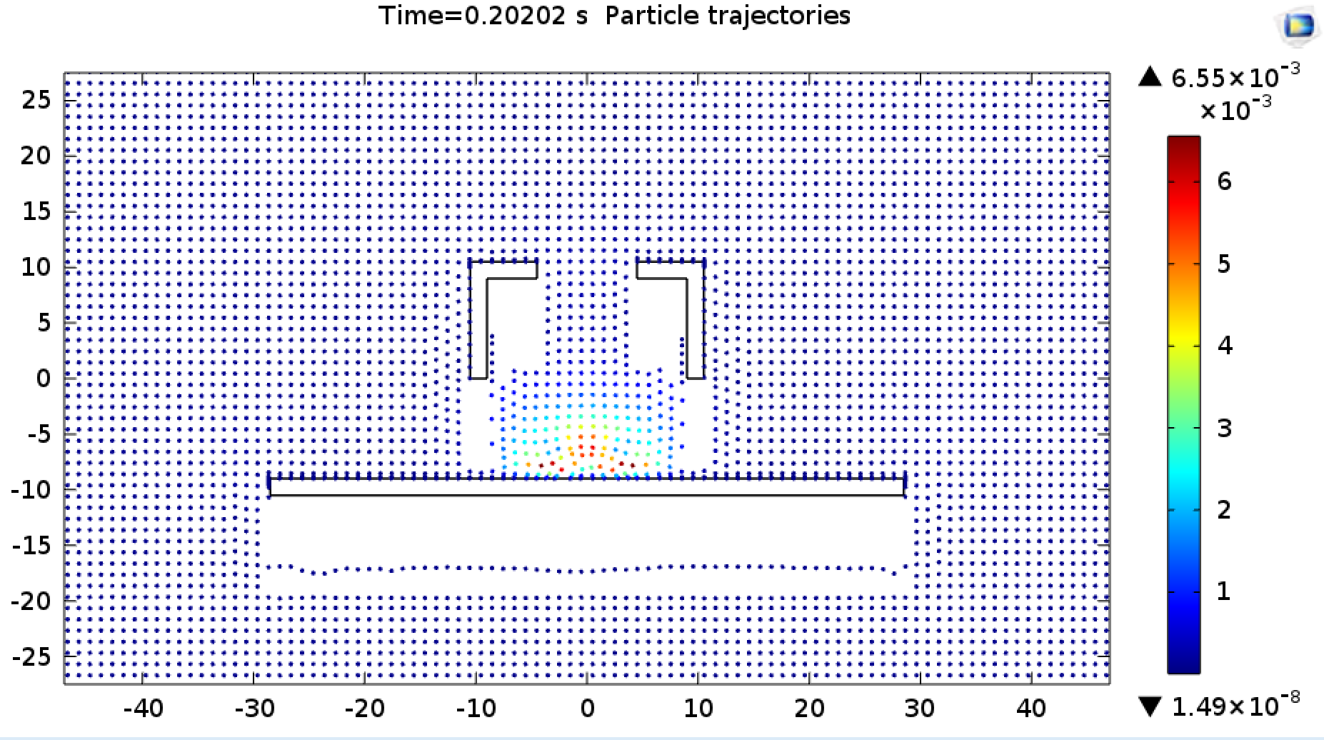

The first study seems to give reasonable results, but in the 2. study in the first time step all particles fall down 1 cm.
- I decreased the 1. time step to different very small steps, but the result is always the same.
- I disabled the gravity force in the particle tracing study, but the result stays the same.
- When I disable the volume force in the laminar flow, the problem does not appear anymore. But obviously the results are wrong in this case
This behavior seems to be physically odd, because the effect of gravity should happen over time and not instantaneously, since the density is supposed to be a function of temperature.
For the volume force I can only use: F=-spf.rho*g_const
