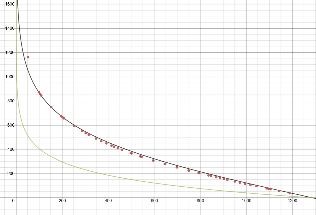

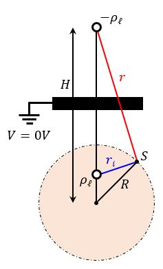

I have an analytical formula for potential distribution (by image charge method) when the line charge is floating on grounded plane, which is,
V=P/(2*pi*eps)*ln (ri/r)
Also I did numerical simulation exactly same system with that of analytical one, the result is different, please find attached COMSOL simulation file.
If I scale the analytical function with 1.7, then the curve matches beautifully, see attached picture file
Red dots : simulation result.
Green line: analytical model
Black line: analytical model * 1.7
I manually found out the value 1.7, at this point, I have no idea where this 1.7 is coming from.
I think the simulation set is fine..
Is there anyone who had similar experience with me?
or know why the curve matches with COMSOL result with scaling factor 1.7?
or maybe my set up in the simulation wrong?
If simulation set up is fine, I think either Gauss Law or COMSOL simulation results is wrong.
Thus, simulation set up has to be the issue, but I can't find what is the problem in set up.
Thank you.
Thank you.
