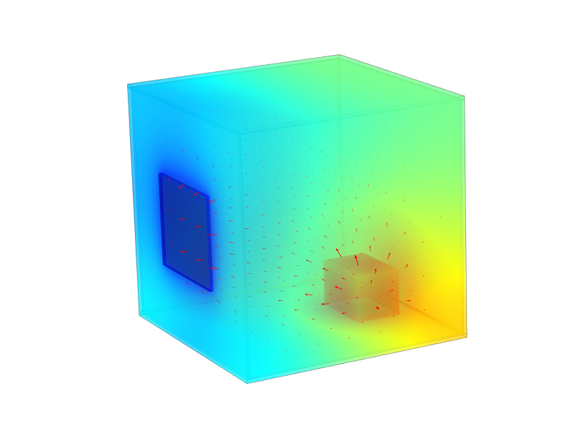

You have to think a bit about exactly what you want to model.
In practice, the casing will probably "leak" heat away through edges. If you want to take that into account, you have to make an estimation and add a small heat flux at some edges. What is the temperature outside? Is the heat source homogeneous through the block? Are you looking for a stationary solution or a time-dependent analysis? Etc, etc.
I definitely recommend doing a tutorial. Please contact your local sales office for one: www.comsol.com/contact/offices/
I took a look at your model and did a simple calculation on it, putting a heat source of 100 W/m^3 in the block and a heat flux to the outside through the window at a temperature of 10 degC, with a heat transfer coefficient of 5 W/m*K. I have not taken into account material properties, other effects, etc. You will have to think about that. I'm giving you the model as a starting point, but don't consider it to be holy.
Good luck!
