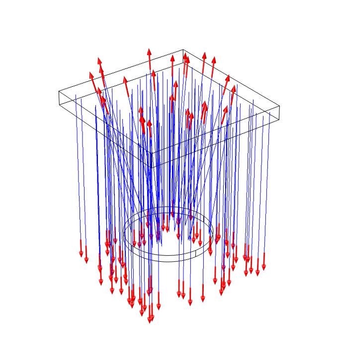

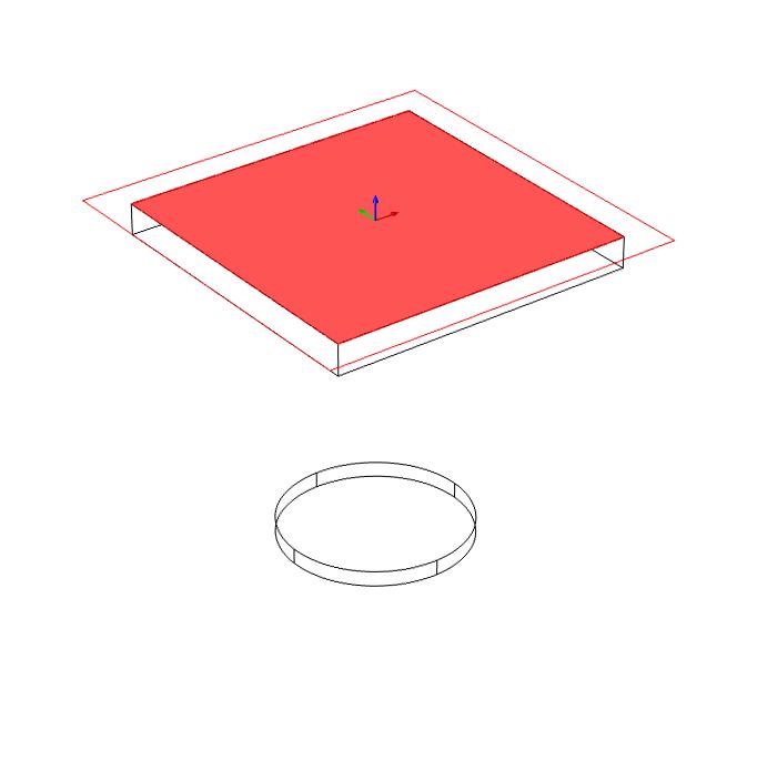

File 1 attached is the ray tracing and the red plane in file 2 is the surface on which I want to know the phase of the rays.

The solution is to define a cut plane where you want to evaluate the phase, then use the Poincare Map plot type to create a spot map of the phase. The Poincare Map plot type allows you to plot quantities defined only on the rays at the intersection point between the rays and a geometric entity. You can refer to the attached (V5.2) model to see how to do this.

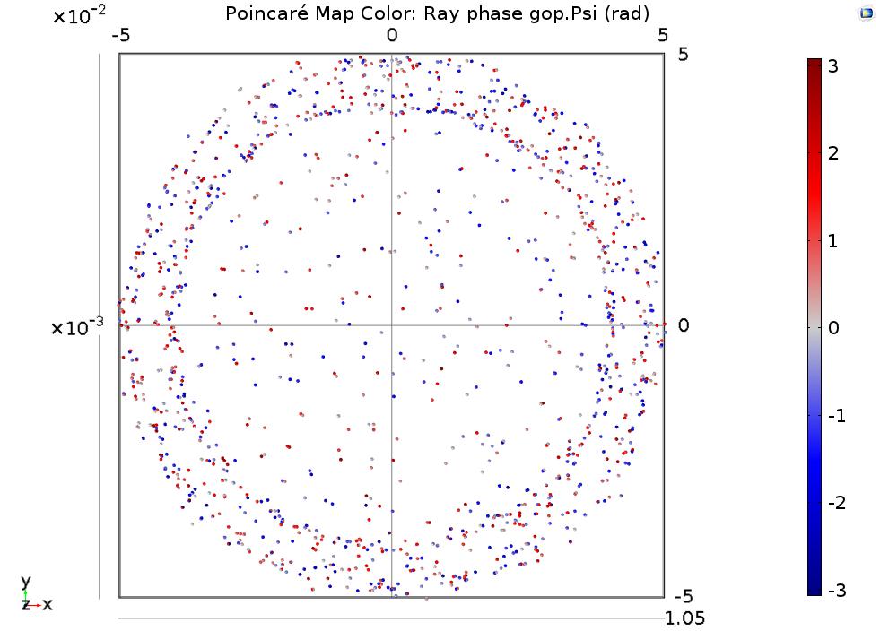

I tried the poincare map and it works well when I'm using the color expression and plot gop.Psi, but the results are a little bit weird, I expect a symmetrical phase map and it is not symmetrical (see attached file).
Maybe, has Ivar said, I need a reference ray. How can I define a reference ray that will intersect with the middle of my "cut plane"?

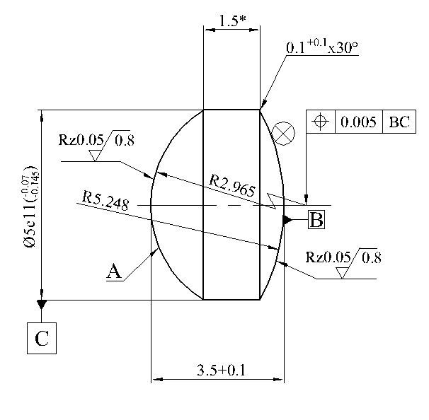

As for the lens parts, it was quite unusual for me to provide COMSOL with edge thickness for a `spherical equi convex lens 3d` (`Te` dimension) in Part Library. It is preferable to type an axial thickness, radii of carvature and a diameter for a lens to be built. Attached you will find a typical lens drawing for a lens. Such drawings are very common in Russia.
