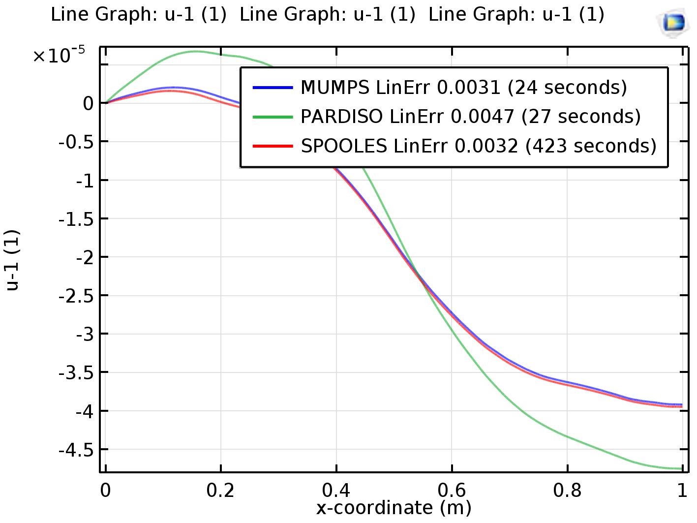

Having had some problems, I reduced them down to a surprisingly minimal example:
• 1D, single interval, Laplace equation.
• Dirichlet BC on left end: fix it at "1.0".
• (There is a zero-flux BC on the right end by default.)
• Mesh has 500,000 equally-sized elements.
• Everything else is at default values.
The result comes back with a massive error (see the plot, attached) and relative error indicator (LinErr) of 0.0031 (MUMPS), 0.0047 (PARDISO), 0.0032 (SPOOLES).
The error is solver-dependent for the three direct solvers, which should all be, theoretically, producing the same answer. But they are not, as can be seen from the residual plot. All answers are bad by at least 0.0003 at the free end. So we only get 3 significant figures accuracy out of this trivial simulation.

Posted: 10 years ago Mar 30, 2016, 4:22 p.m. EDT
The condition number for the stiffness matrix for this problem can be shown to be where C is a constant of order 1 and n is the number of degrees of freedom. So with a million DOFs, you can expect a rather ill conditioned problem. The calculations are done with approximately 16 significant digits.
You are right in that a million DOFs is not extremely large per se, but it is uncommon in 1D!
A 3D model with the same number of DOFs would be a 100x100x100 cube, and then the condition number is of the order instead. To reach the same level of ill-conditioning on a cube, you would need DOFs or so.
This does not imply that ill-conditioning is not a problem in practice. Most real structures are not cubes, and mesh size or material data can vary widely. Attaching rubber to steel in a structural analysis can kill five of the available significant digits.
Your example is however not usable for checking mesh convergence, since there is no discretization error. The only thing it can capture is the numerical round-off errors since the solution can be exactly represented by a single element. You need a source term which gives a more than parabolic variation of the true solution to do a mesh convergence analysis.
Henrik

Posted: 9 years ago Apr 12, 2016, 8:00 a.m. EDT
Hi, thank you Henrik and Daniel,
The condition number being a function of the level of refinement was indeed the key to my problem.
However, the cube example is at the opposite end of the spectrum, i.e. one of the safest possible models as far as condition number is concerned. Yes, 1D problems are not typical, but slender 2D problems are common enough to encourage the need to be mindful of these issues (well, I'm working on one right now).
After a bit of experimentation in 2D with NxM grids, it seems that the longest edge (in terms of the number of elements, so max(N, M)) determines the condition number in exactly the same way as running a 1D simulation with N elements.
The next question that arises is: what is the effect if we have some coarse areas and some densely meshed areas? To look at answering this, I've built a simulation with a few horizontal layers, of thicknesses 1, 2, 4, 8, ..., n^2, ..., 2048, and meshed the edges between them with 40960/thickness vertices. Meshed the domains with Delaunay triangular mesher. Applied Dirichlet BCs (= 1) on the left boundary of the model. (Model is attached, but note it does take a long time to mesh.) The results are:
