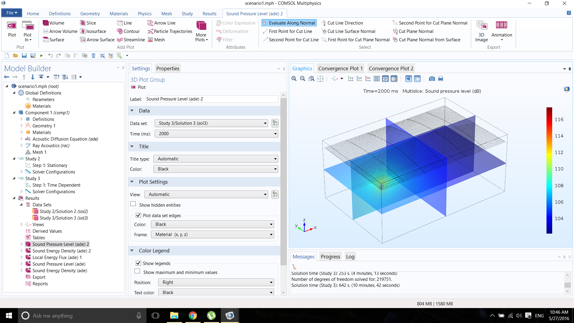

I have just started using Comsol several days ago and I was trying to defive Reverberatin Time for a room. But no matter what I do not get the Reverberation Time at all even as an option.
I tryied adding Acoustic Diffusion Model as well as Ray Tracing Physics together with Stationary, Eigenvalue and Time Dependant Study in various combinations.
I fact my goal is to get results of how ceiling shape affects the acoustic of the room (obtain Sound Pressure Maps, Reverberation Time, Ray Tracing Maps).
Thank you. I would be glad if you can help me, as I feel stuck right now. I attach some screenshots for better understanding.
