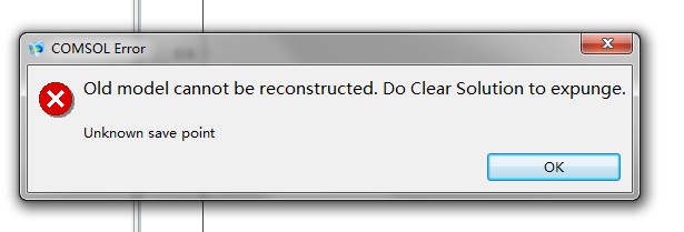

I use the COMSOL 4.1 to do some parametric sweep, but the error appeared.

reading in old models are not always possible, I always restart from scratch, the best copying from the fields
Try a "file clear solution, clear mesh, reset model", and then rerun it
Hi reading in old models are not always possible, I always restart from scratch, the best copying from the fields Try a "file clear solution, clear mesh, reset model", and then rerun it -- Good luck Ivar
