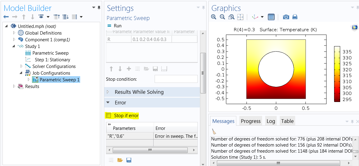

The setting that will probly help you can be found in
Study > Job Configurations > Parametric Sweep >
Settings Window > Error > "Stop if error"
If you disable this setting the solver will not stop but merely report that for a given parameter an error was encountered, all other solutions will be produced.
See my screenshot for explanation: The sweep contains a configuration R=0.6 for which the problem cannot be solved. The solver will return all others and report the error for 0.6.
I hope this will help you.
