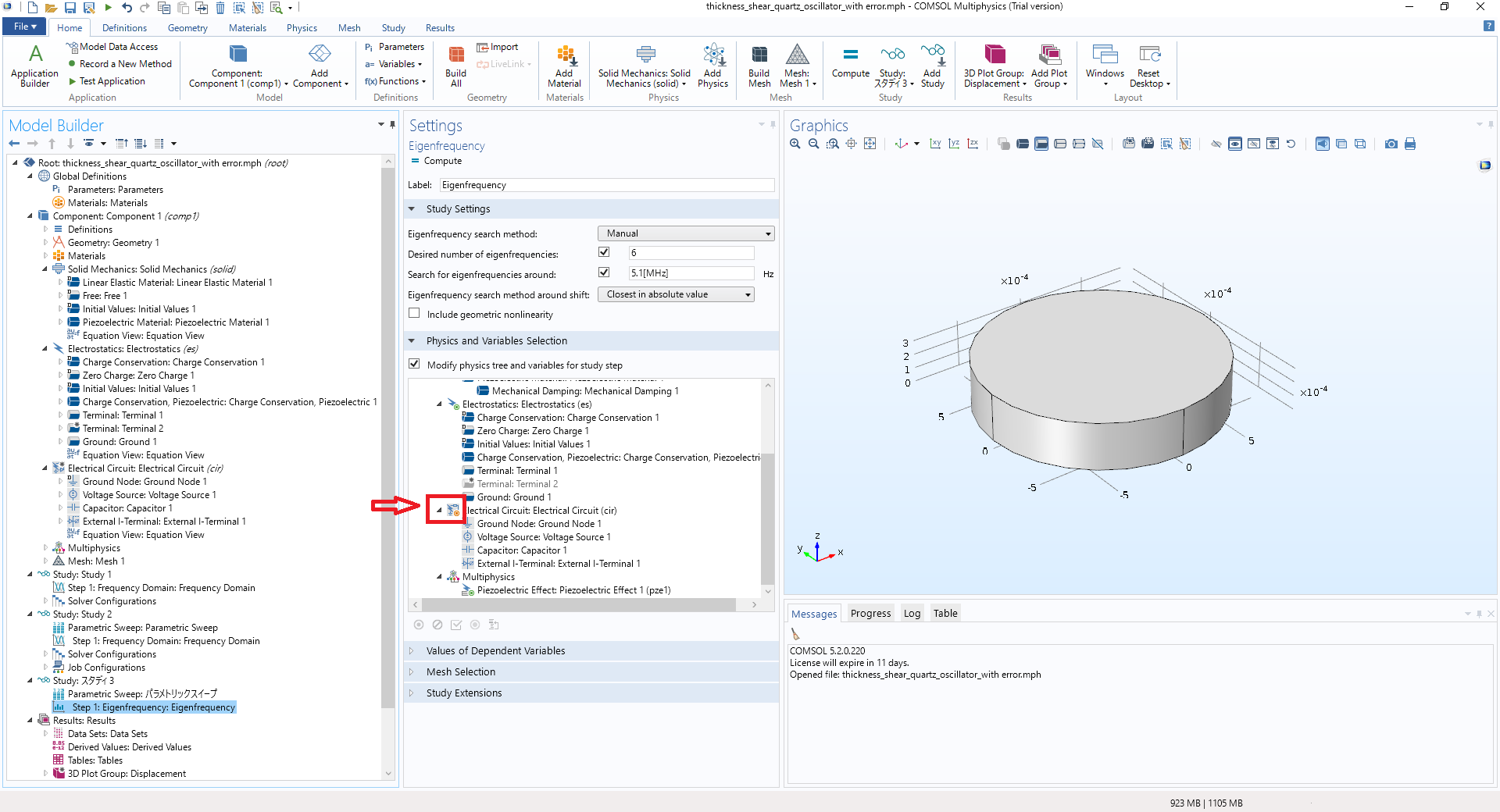

Attached is revised model based on the example "thickness_shear_quartz_oscillator" from Comsol library.

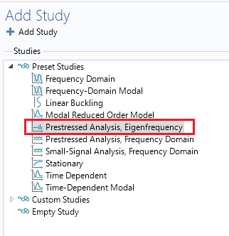

We used study type of eigenfrequency, unlike the model in the library. However the equations of Electrical Circuit interface are not included in the eigenfrequency study as attached png file ‘EC interface’ shows. We failed to make the simulation.
Therefore, we are considering other possible way to deal with this problem. We want to firstly involve the Electrical Circuit interface and get the Pre-stress, then exclude the Electrical Circuit interface and get the eigenfrequencies of the pre-stressed piezoelectric device. Is it possible? There is study type of Prestressed Analysis, Eigenfrequency as attached png file ‘study type’ shows. Could it be used for this calculation?
