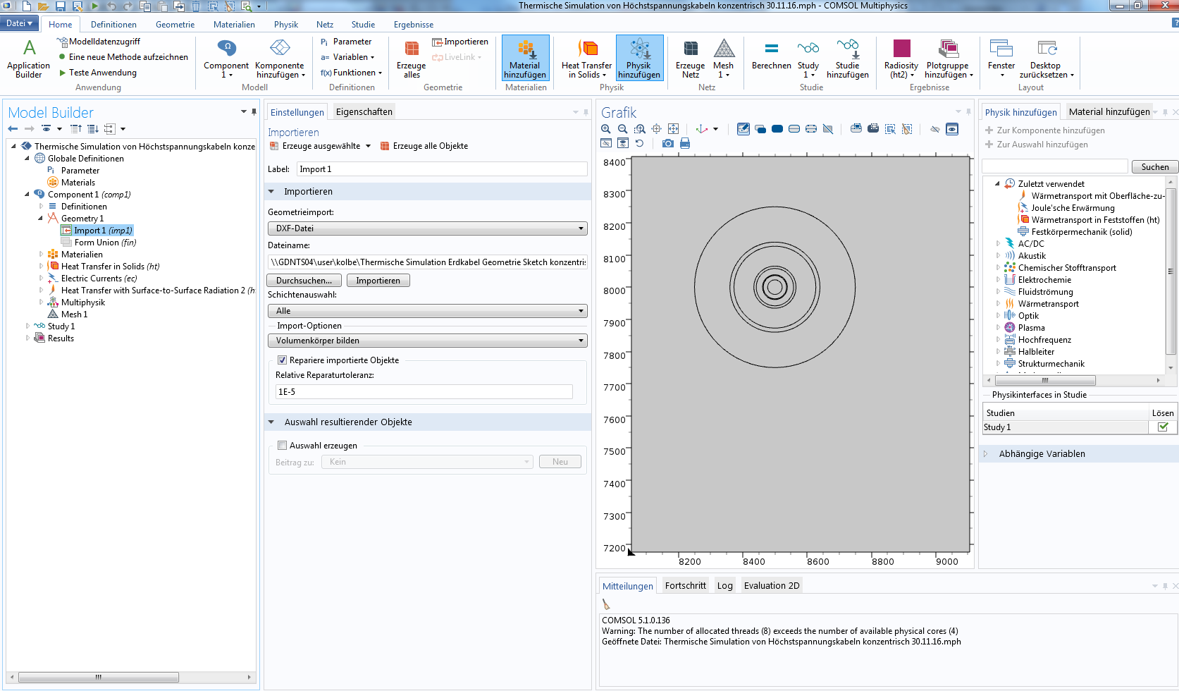

Somehow I'm struggling with the connection between COMSOL and Inventor.
The LiveLink button in COMSOL is not active so could it be that my license does not contain the LiveLink™ module (Picture 2)? I put some pictures in this thread.

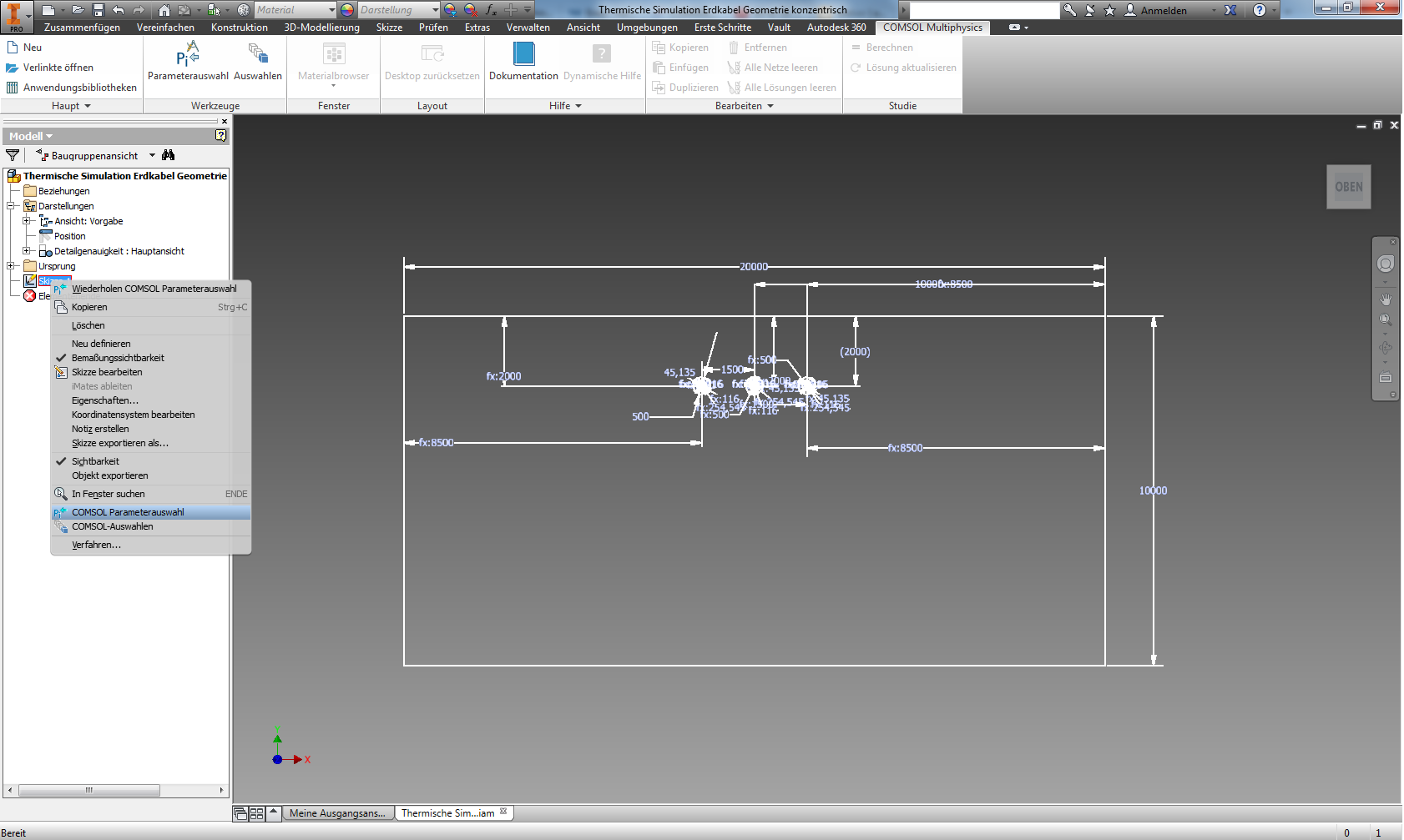

1. 2D-Sketch in Inventor with definings (parameters)
2. Right-click Sketch and choosing COMSOL Parameter Selection (Picture 1)
3. Enable "Add to COMSOL Model" for all Parameters
4. Export sketch as a .dxf file
5. Import .dxf file in COMSOL at geometry node
My parameters are not there. So I wanted to try out LiveLink™ but I came to the problems above.

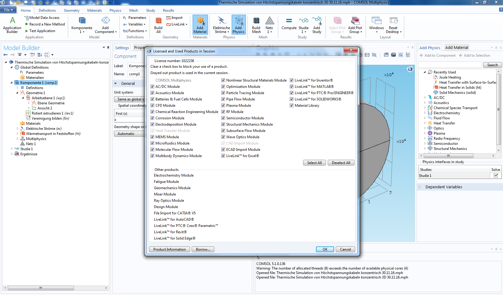

Relating to the COMSOL License settings I have the required license for LiveLink (Picture 1).

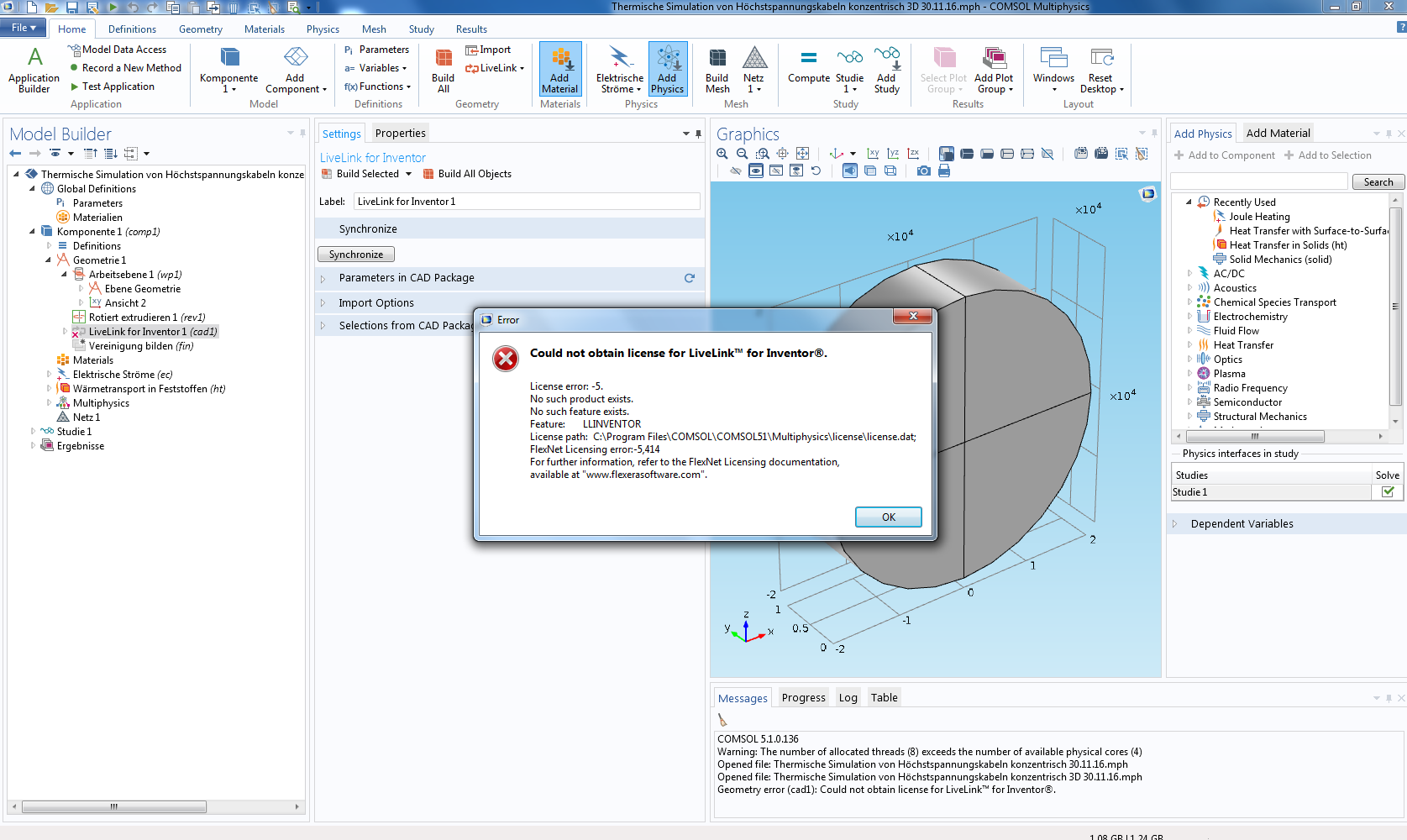

Somehow if I want to synchronize between COMSOL and Inventor the error on picture 2 is displayed.
