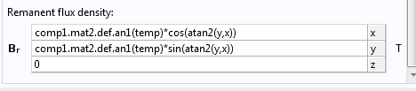

I am trying to simulate the diametrically magnetized arc neodymium magnet in COMSOL 3D. But I don't know how to define the Remanent magnetization of diametrically magnetized arc magnet in x, y ,z coordinates. Can anybody guide me regarding this ?
