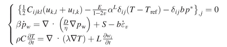

I am stuck with a tensor problem. Can you please help me solving these coupled pdes(Attached in the image). The unknowns are u, pw and T
Dear Aminul,
Your problem is significantly different from mine.  While I am trying to solve for a quantity which is a tensor field, you merely have a tensor as part of your coefficients.
I'm not saying your problem is trivial, but I think it can easily be handled by Comsol.  From the Mathematics module's PDE interface, use either the coefficient form (easiest if you can put your problem into that format), or else the general form.
From the information provided, I cannot quite figure out the form of your problem.  It looks to me that you have two coupled predictive equations (eqns 2 & 3), meaning they each have a time derivative d/dt.  The third equation (eqn 1) looks like it is not needed for the time evolution but is only used to compute the vector field u after computation (but perhaps I misunderstand; perhaps eqn 1 provides a constraint on T and pw which I don't see because I don't understand what physics you are solving).
Regardless, you can select the PDE coefficient form several times, probably once for each equation.  Using the source term, you can couple the equations.  I have just tested this with a simpler system, and apparently it is OK to include constraint equations without time derivatives.
