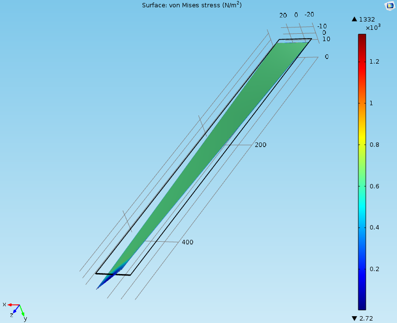

I want to use Comsol to simulate a rotation of very thin and long plate (x:50,y:1,z:500 & rotation axis : z) deformed into a twisted structure. Maybe, I can define geometry with symmetry axis or not... anyway the point is that I can't model such a rotation with Solid mechanics or Multi body dynamics.
I input "prescribed diplacement" with x and y direction as a zero to fix one end (edge at z=0),
and "rigid connector" with prescribed rotation at center of rotation as omega (0,0,1) and 180[deg] to rotate the other end (edge at z=500). But, it ended with following error.
Failed to find a solution.
The relative error is greater than the relative tolerance.
Returned solution is not converged.
Do you think it is related with material properties or the physical constraints?
