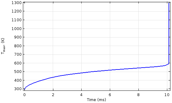

Add Free Tetrahedral node and set Element Size to Finer. After 10 ms temperature is exponentially growing, as shown in the attached image.

When I do exactly what you said, the reciprocal of step size starts to increase after overall progress reaches to 56%, ultimately leading to convergence error. Did you add stop condition to prevent it from going to inf? Or did you change any solver config to have that graph?
