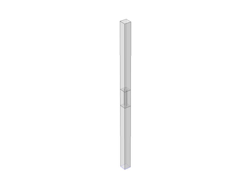

I'm trying to calculate reflection and transmission for a system where (structure attached) we have an periodic (both in x and y direction) system of Si pillars lies in a certain matrix. The periodicity is 400 nm. Light is coming in the z direction perpendicular to the xy-plane. I was using the (user defined) port boundary condition to define the incoming wave and measure the reflection and transmission.

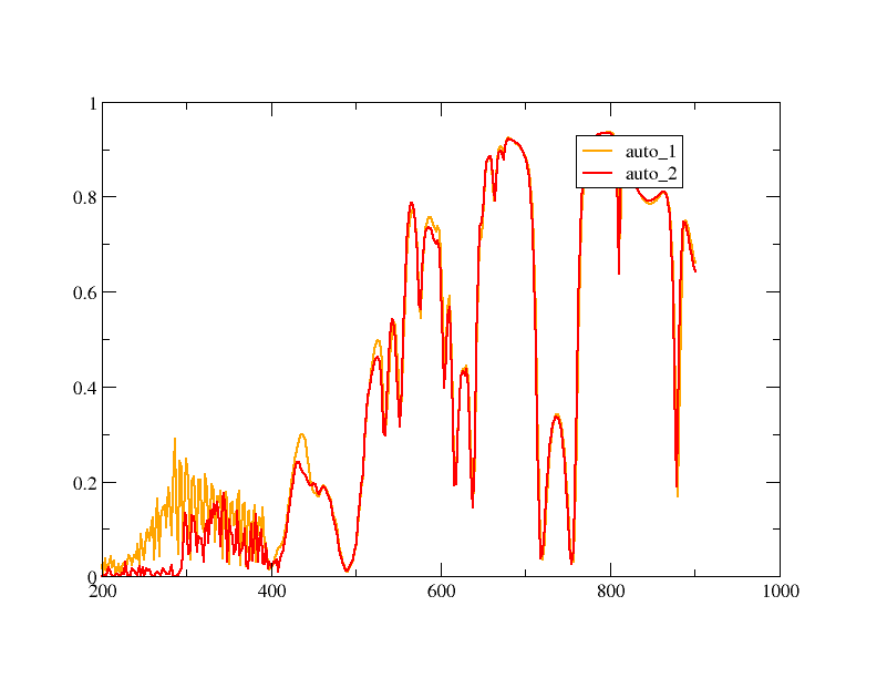

However, the port setting works fine for the spectrum above 400 nm and shows wired wiggles (also attached) for below 400 nm, which is actually the region where diffraction start to make a difference for this system. I was wondering if anyone have seen such kind of problems before and can help me on what's going on and how to correctly simulate these diffractions?
The two labels in the transmission are results using two different automatic mesh where auto_1 is actually the densest auto mesh COMSOL could have so we can't to higher with auto mesh. If anyone have seen this problem and have confirmed that this is indeed something about mesh I may try a denser manually input mesh.
