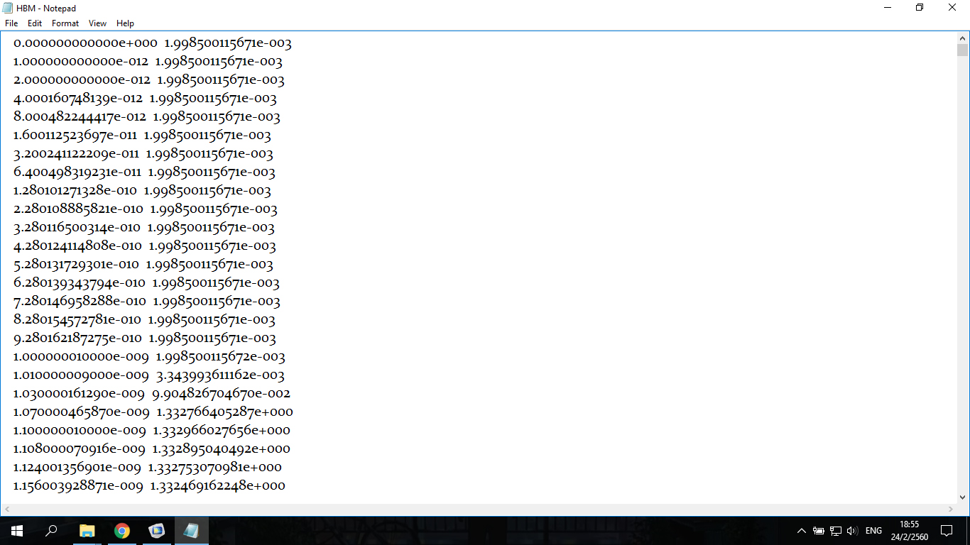

HELP ! can i set the current input with this file ?
i have .txt file and , in the 1st column is the time, and the 2nd column is the Current , can i use this .txt file into this model . and see the temperature

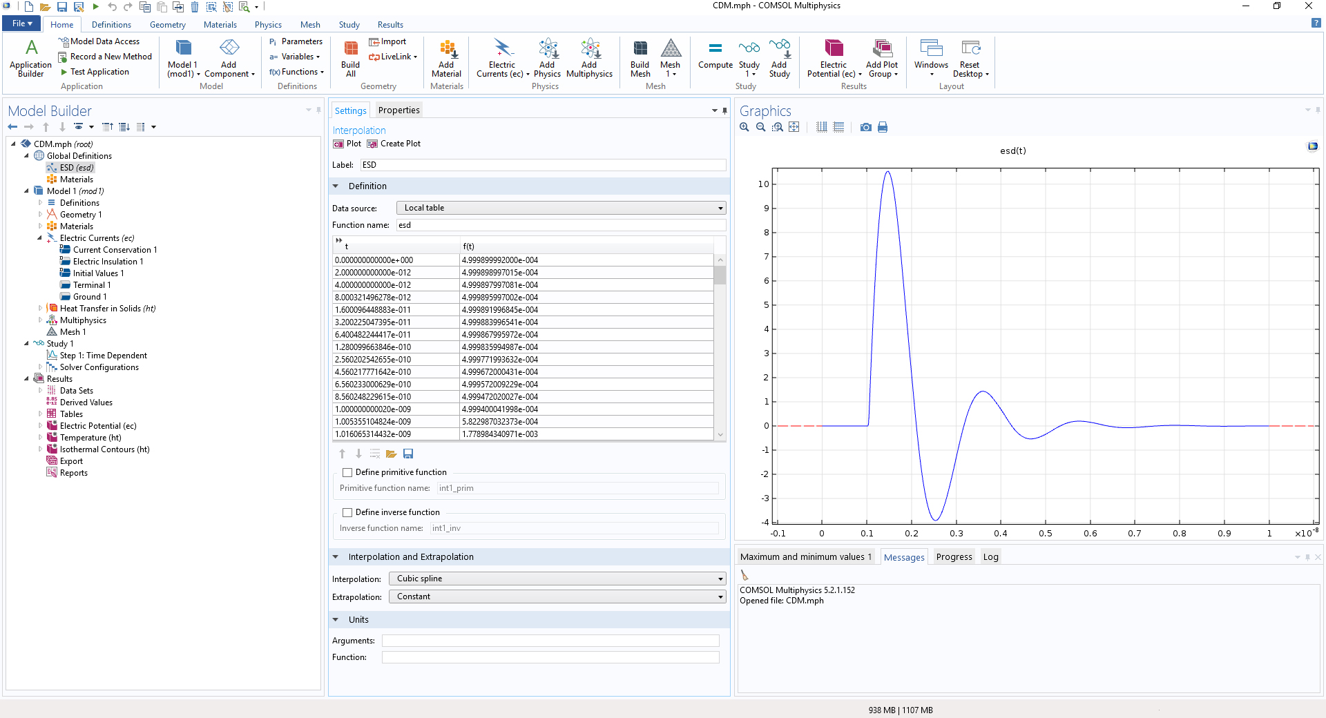

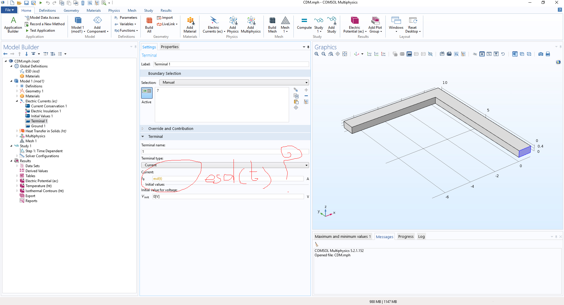

now i can import Interpolation Function in 1st picture right? and then i put the function in the Current input in 2nd picture right ?
Hi, Jeff Thank for the answer. now i can import Interpolation Function in 1st picture right? and then i put the function in the Current input in 2nd picture right ?
