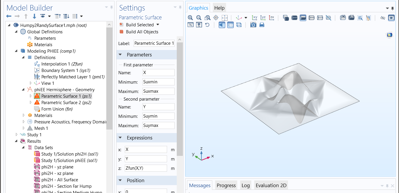

Posted: 9 years ago Mar 8, 2017, 5:48 p.m. EST
Hello Jeff,
Okay. I will do that. Find attached what Am talking about..
Actual Surface: is the actual figure
Surface after using the Parametric Surface: This is what I see after using the Parametric Surface.
Hello Jeff, Okay. I will do that. Find attached what Am talking about.. Actual Surface: is the actual figure Surface after using the Parametric Surface: This is what I see after using the Parametric Surface.

Jeff Hiller COMSOL Employee
Posted: 9 years ago Mar 9, 2017, 8:12 a.m. EST
Hi Daniel,
Have you tried increasing the number of knots that are used to make the parametric surface?
Jeff
Hi Daniel, Have you tried increasing the number of knots that are used to make the parametric surface? Jeff

Posted: 9 years ago Mar 9, 2017, 2:20 p.m. EST
I did try to increase the number of knots. However, It's still the same.
